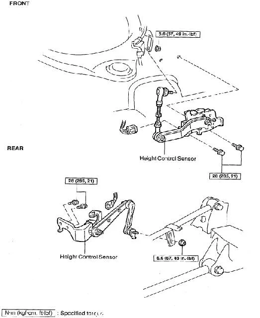

Adjusting your AHC sensors are fairly easy ( job). You'll need to furnish/fabricate a simple bracket extension which I'll cover in step 5. You'll also need one can of AHC fluid from Toyota $22/can. (part # 08886-01805). I have heard the exact fluid costs more if bought from Lexus.
1. Take measurements of your ride height at each corner of the vehicle. I recommend measuring from the fender lip to the bottom wheel lip.
2. Turn off ignition. Jack up the front, secure with a jack stands and remove your front wheels. Locate the Height Control Sensor as seen in the diagram. Note the position on the adjustable top mount. You are going to want to slide it up as far as possible in the next step.
3. I found it easiest to just remove the top nut of the heim joint (10mm) and adjust the rod so that it is as short as possible. This will give you about 2" of lift in the front. If you want 2.5", you'll have to shorten the heim joint (I used a cut-off wheel) and then used the existing stop-nuts to "smooth out the thread" and actually remove the stop nuts completely. Be careful because one side is a reverse thread. Not many people I know have a reverse cut tap/die set.
Once done, reinstall the heim joint and adjust it so that the Height Control Sensor lever is as high as possible. Remount the wheels. You can readust the sensor through the wheel-well later. Make sure ALL adjustments are done while the vehicle is OFF for safety reasons!
4. After the front sensor adjustments are done and all jacks are cleared away, you can start the engine. All the doors, hatch and hood need to be closed for the AHC to work. This adjustment will yield up to 2.5" of lift in the front.
5. Now for adjusting the rear. Again, make sure ignition is off. No need to remove the wheels, just crawl underneath and locate the Height Control Sensor. There is only one for the rear. If you slide the adjustment to the top, you'll gain about 1.75" of lift. For more, you'll have to extend the mount 2" or so. I used 1" aluminum flat stock and drilled two holes (to mount to the existing bracket) and slotted a 3rd hole for adjustability. If you space out the aluminum stock from the old bracket 3/16" of so, you can get better adjustability.

Edit: Perhaps more important than the amount of lift is the amount of droop left in the suspension. If you lift too much, your suspension (shocks) will "knock" (top-out) when going over bumps. Here's some advice from ATS4X4:
You should maintain a minimum of 70mm [2.75"] of droop in the 100 IFS front set up, if you have a Slee diff drop fitted, to stop the cv boots wearing out. [boot pleats shouldnt be touching in straight ahead position at ride height]. This is normally 50-60mm higher than standard, depending on accessory levels. On a 16" rim this makes for 770mm [30.3"] measurenent from bottom of rim bead edge up through centre of wheel to fender edge when set up correctly. Rear should be aprox 790-800mm [31.5"]
