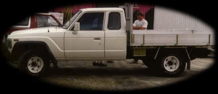

HJ60 chop is complete - UPDATED PICS

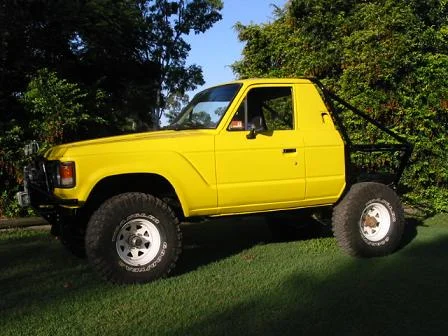

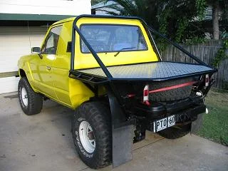

Some or you may remember around February I posted some pics of my HJ60. I also mentioned it was getting some treatment with a 9" grinder.
Well...With just 3 days short of a month gone since the first cut was made...it is finished!
Will give you all a brief rundown on events before I post some pics for you.
The chop and tray were completed within the 5 days that we allowed, everything went off without a hitch...and any hitches that did pop up were easily sorted out. We used the top half (hatch) section but manufactured to plates (inside and out) for the bottom section where the tailgate normally is.
Didnt bother with a side window in the new "B" pillar as visibility is not affected. With the hatch being used at the rear it allowed us to keep the rounded corners, and not have the flatback look that many others have. This IMHO is much better looking! And I even left the windscreen wiper on the back, not too many utes have a rear windscreen wiper afterall.
The back of the cab lined up beautifully with a body mount, so there was no need to move or add any mounts.
We also cut just over 400mm off the chassis rail at the back. Which leaves about 100mm hanging out passed the rear hanger. When you look at it from side on, its looks like a short wheel base now
Just in case it is needed, a need tow section was put in at the back. But it was made to suit the hayman reece tounge that is on my 02 dual cab hilux. So if I ever need to tow anything, its all good.
There is still some external bits to go back on, and the interior is still pretty much gutted...but over time it will all be done!
Thats pretty much it...I mean I could go into wicked details, but I am sure there will be plenty of Questions anyways...so I will wait till they come.
Heres some pics of the finished product.

WOW that looks good. Good job on the chop!
Have any rear view pics?

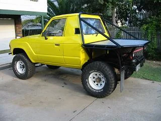

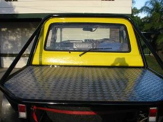

Dont know why you guys are saying "its a crime"....or "I feel a little sad"
The 60 series have never been what I would call a good looking vehicle...so I chopped the ugly bit off.
anyways...that all comes down to personal preference I guess...we cant all have trucks that look the same, otherwise the world would be a very boring place.
Here are some more pics for you guys.
I cant post too many, as I am only a new member. Limited picture space apparantly.

Nice work, I love the tucked away spare tire/tyre.
I suppose those of us who live in the rust belt of North America are constantly fighting with rust issues and that's why you have people piping up regarding choping up a nice clean 60 series.
Would you consider any horizontal bars for protection across the back of the cab (might save your rear window) if you decide to haul anything on the tray/bed.
I do love the fact that you kept the rear squirter for the wiper (it's the little details).
Again, nice work, have fun!

With the rear section (at the bottom), a panel was fabricated to weld to the bottom of the hatch, and then welded to the floor from underneath. This panel also has 2 H channels tacked onto it (inside) for extra strength and support. We rolled the sides to match the rounded corners at the rear.
With the inside panel, a bit of fabrication was done here also. But this was just a 90 degree fold at the top, and another 90 degree fold on the bottom (going the other way though). Another piece was welded in the corners just to neaten things up a little.
Dont know if these pics show what you want to see, but here goes anyway.
P.S Didnt realise the 60's were uncommon over there...I always thought they were a dime a dozen type thing.

The placement for the spare is a common thing over here...keeps it out of harms way, and helps keep C.O.G down low as possible.
Yer, they are tie down rails....I guess...mainly they are there for a bit more protection from trees and so on. And they look BLING!
As for bigger meats...I am already running 35" now. In the state I live in SOA are illegal. So there isnt much more I can do to fit bigger tyres.
The rear windscreen wiper and squirter still work! they aint just there for show. I wanted to keep the button to open the hatch as well...but before I new it a plate was welded over the hole and it was gooooone.
Theres a few 60's dual cabd getting around here actually...but I dont like them. I dont know if its because they used a flatback panel to close it out, or just the general shape.
theres all the other replies done :-)

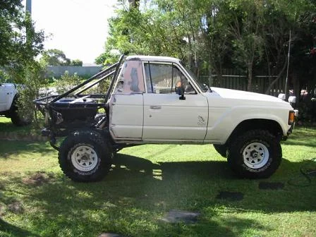

Im a little disapointed too ,I like them chopped to look like this one
Oh and nice work by the way,we got plenty of good rust free 60 so keep choppin
