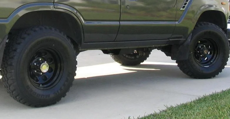

These worked for me. Series 51 black rockcrawlers from 4wpw.com
Part # 51-5883R2.5
15X8 2.5 inch back space. Just barely rubbed the caliper on one side. If the paint.job on the wheel was thinner I don't think they would have rubbed at all.

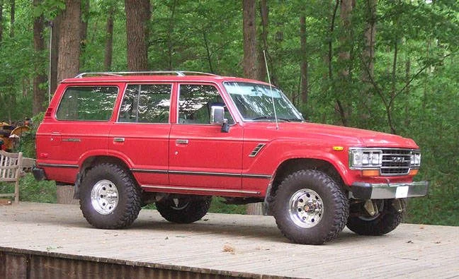

767-5183, American Racing, 767, 15"x10" Taken from PO's sales receipt.

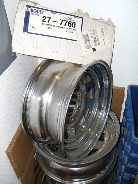

Unique Wheel 27-7760 3.5in backspacing
16x7
6 on 5.5

Toyota 42601-60262-03 is a 16x6" with 3.75" BS. Heavy duty grey steel wheel. You will clear the calipers and TRE's however lose .5" total stance.
Unique 7760 series steel 16x7" with 4" BS will work and clear the TRE's. (Thanks to Rob Mullen for sourcing this number years ago). You will clear the stock calipers, and TRE's however lose 1" total stance. You may rub inner wells if running 255/85R16. You can order the Uniques custom BS'd from the factory to 3.5" BS.
21-7760 is white
42-7760 is black
27-7760 is chrome
The factory steel wheels are considerably heavier then the Uniques, however I have not had any issues with the Uniques yet.

I got them through Discount Tire a couple of years ago. I had the part number, and made sure the guy called Unique while I was there.

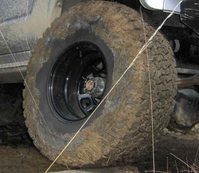

Rock Crawler by Pro Comp 15x10-5.5" REV 2.5" BS. Part #51-5183R2.5.
Reverse backspacing that really put the wheel out there. Flares would be recommended. Slight touch at caliper, but it was so slight I just ran them and let it work itself in rather than trying to grind the caliper.
Running 35x12.5 BFG A/T's on them.

I just e-mailed Bob DeYoung at the Unique/Cragar Factory and he confirmed the part number, but said they were 4 inch B/S, not .35

They allowed a special order with 3.5-inch backspacing. I made sure the guy at Discount called and confirmed they would build them.

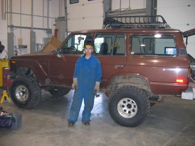

Just picked these up from Summit...
# USW-84-5860L 15x8 daytona wheel 6 x 5.5 lug (pictured above). I had to use a 1/4 in spacer, other wise they would have rubbed a bit (minimally).
For 41 bucks, they were a BARGIAN!

NOPE, still had pleanty of stud...The PO had the spacers on there before I did too. I did tighten the F*#K out of the lugs though.
16x7
6 on 5.5
Not sure how long ago that was posted. I inquired about these and got only terse responses that they are no longer available or even custom made.

15x8 Eagle 589s, 3.25" backspacing. running 33x12.5 with just extended shackles and no fitment issues. with 3.25" b/s, fronts do sit a bit proud of the fender.

How much space do you have between the wheel and the caliper?

i'd say roughly 3/16" to the front calipers and 1/4" in the rear. stick-on wheel weights are tight front and rear, but i haven't lost any yet. i did flatten them a bit with a deadblow before mounting the tires, just to be sure. probably a good thing i did.

15x8 eagle alloy model 186's.

forgot to attach pic:

3rd try's the charm.
