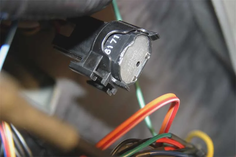

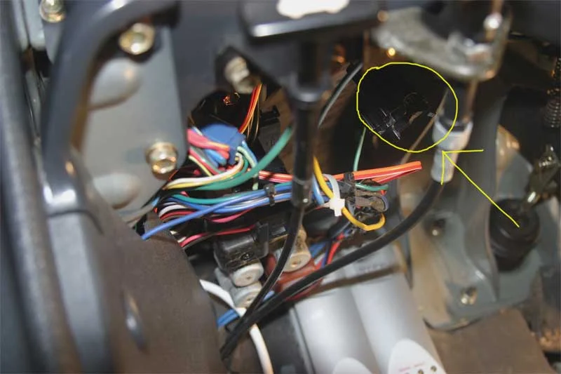

FJ62 Door Lock circuit breaker fuse location
Do your door locks not work on your FJ62?
Try resetting the circuit breaker. Use a paperclip and insert into the hole on the silver top of the breaker. It will "Click", then it is reset.
It's located right around the other relays and electrical stuff behind your fuse box and the hood release.

Mine doesn't click. Does that mean the circuit breaker is shot?

does the truck need to be on or the key inserted?

No, not that Iam aware of.

sooo awesome. i tried it with the car off and then turned it on and tried the door locks. worked perfectly. its been 2 years without power door locks. thanks a lot!!

Worked for me, too! Thanks! It didn't click, but the locks work again...
I had the same with my stereo btw. It crashed and resetting did the trick.

Is this only for when the locks don't work at all, or?? My locks work intermittently, and even then, not all of them work....Gracias

This will be for when they don't work at all. The circuit breaker will turn the entire system off if it needs to be reset.
