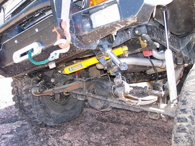

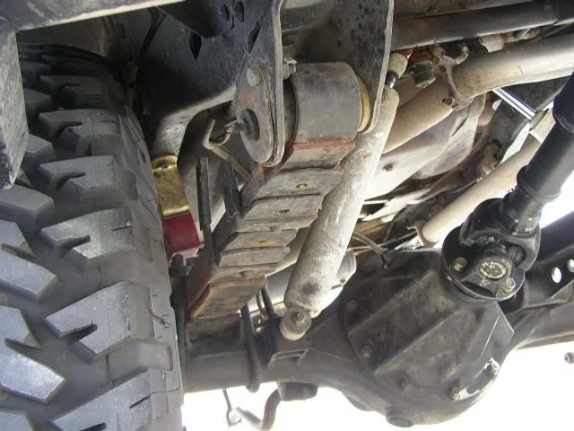

But.... If you absolutely want extended bumpstops, by some for a Jeep Wrangler, the earlier one with the square headlights. The bolt into the factory spots. Available in 3 lengths up to 3"
Gary

is that an arb/62 in the second pic? the light and grill look different.

waggoner,
I was made by Stout Equipment in NM, but they are gone now. 1/4 plate....Really heavy.
