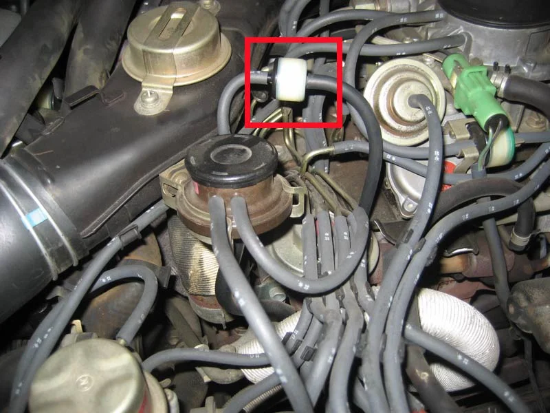

Valve b/w modulator and EGR valve?
Scott (and others)- I need pictures of your rig between the EGR modulator and the EGR valve. Actually what I need to know is do you have this valve (red circle) inline between the modulator and the valve. If you do have it which way does it flow? If somebody with an emissions sections FSM could look that would be a great help. I own the three other FSM sections !
Its weird b/c the only non-OEM tubing in my entire rig is between this valve and the EGR Valve.
Thanks for any help.

circle square, whatever.

Nope, mine does not have a VTV there, and It's not in the FSM. I'll try to get a pic of mine up tomorrow- so everyone can tell me what's wrong with it (although I think it's all stock)!

Thanks Scott. I bet your is correct and mine us SNAFU. Can't wait for more opinions/pics . . .

not stock
that valve is absolutely not stock. it should just be a hose there.

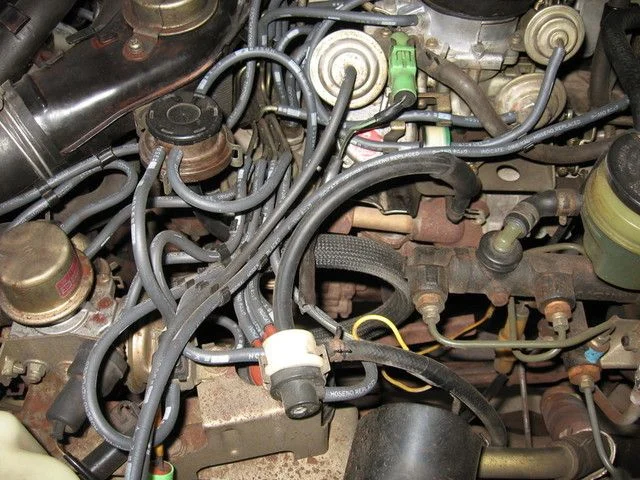

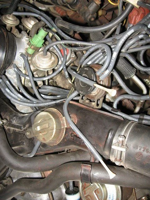

EGR bypass pictures
Here's some pictures. The first one is the EGR in stock form.
The second picture is my fancy golf tee bypass. I used a small 6 inch piece of spare vac. hose to connect to the EGR modulator to be able to cap both ends.

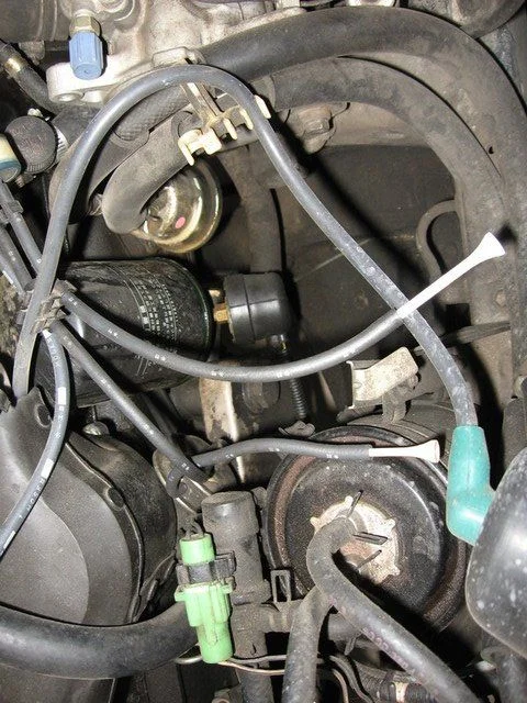

EGR Bypass
For me, bypassing the EGR solved a major bucking and suging problem from about 1200-2000 RPMs in all gears. I instantly had more power.
Problem was, on the highway I had pinging when accelerating especially at about 1/2 to 2/3 throttle.
So, I read about bypassing one of the distrubutor vacuum advances. This picutre shows which one I did- I think it's the primary advance?
I really don't understand the function of all this stuff. It is completely trial and error for me.
Notice the VCV inline. I think the other vacuum advance has to do with the high altitude comepensation?
Coincidentally, when I took a 1200 mile trip to New Mexico up to 9,000 feet, I did not know about bypassing the vaccum advance, so I left the EGR in normal (non bypass mode) to prevent highway pinging. At higher elevations, it ran fine.
My plan is to still work through the emissions FSM to trouble shoot each component and find out what is not working. I don't have to SMOG test, but I want my vehicle to be able to pass so I can sell it to one of you someday.
