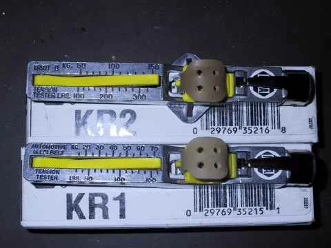

Regarding belt tension, the FSM gives tension specs and shows a tool to use. I looked on ebay for a while for the OEM style tool, but then realized that I would actually need two tools to cover the tension range for all three belts. I ended up purchasing krikit belt tension tools from Napa Online, I think.
I had always heard that you can check tension by pushing down on the portion of belt that is centered between two pulleys. If the tension is correct you should be able to deflect the belt between 1/2 and 3/4 inch. When I checked this method with the Krikit, it was too tight.

I think you can still get the Nippondenso from the Toyota SST provider. The part number seems to have changed to 00095-00010. You'll have to call them to get a price.
OTC makes a universal tool (search "6673") that seems similar to the Burroughs unit (~$150 new). The Burroughs units come up from time to time on Ebay.
From the picture in the OEM Maintenance Procedures manual, I got the impression you would need both--the manual shows the Nippondenso being used on a plain belt, and the Burroughs being used on a notched (ribbed) belt. But maybe I'm reading too much into the picture
The Krikits from Napa are less than $15 apiece. I got both the Krikit I (50-150lbs) and Krikit II (100-300lbs).
