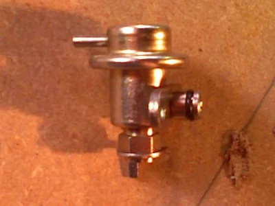

Sean I thought you were the one always saying the fuel presure reg was a problem and it fixs all kinds of problem...........now to find you just now replaced it
I really should do one on Connie's 62, I am sure it needs it.
stupid question(onlu cause I am to lazy to look) which thingy is the FPR?

Posts: 481
Smile
Quote:
Landpimp, The FPR is the one on the driver side of the head, forward & towards the raditor. Kind of a poor discription but that should get you there.

Old 03-27-07, 10:39 AM   #15 (permalink)
Forum Regular
jreed32152's Avatar
Join Date: Apr 2005
Location: Boise, ID
Posts: 207
Its this thing
