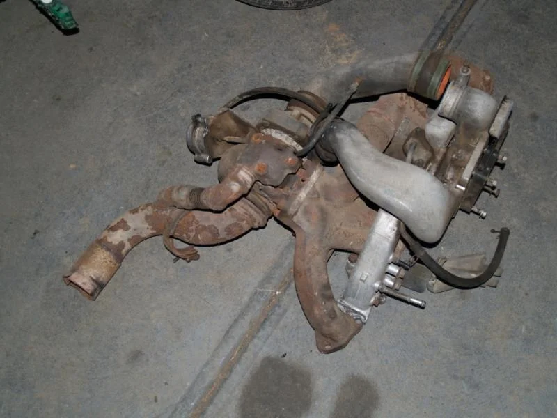

There is a turbo kit for sale here and it got me thinking . ( it includes a intercooler )
My rebuilt 2F is awesome but at 3000rpm on the highway it feels like it needs a bit of help . I just want to smooth out the engine at higher rpms.
If a setup like the one offered by Alpine will maintain my engine's performance in the low-end but add a bit in the high end ,then it could be just what it needs.
I raised CR in my 2F to 9,5:1 and that is the first issue ( I will have to go back to stock CR , but that is not a problem as I do have a spare head ) .
The longer cam ( Delta 250S ) in my 2F will probably suit the turbo and the spare head has hardened valve seats . I am looking for negatives here .
How much will a turbo affect the fuel consumption ?
A long turbo lag is just what I am looking for - so maybe I should consider this ?
Is the carb supplied reliable and as good as the Aisin in long run?
Can a turbo on a carbed engine not cause the engine to run lean easily and start to burn valves?

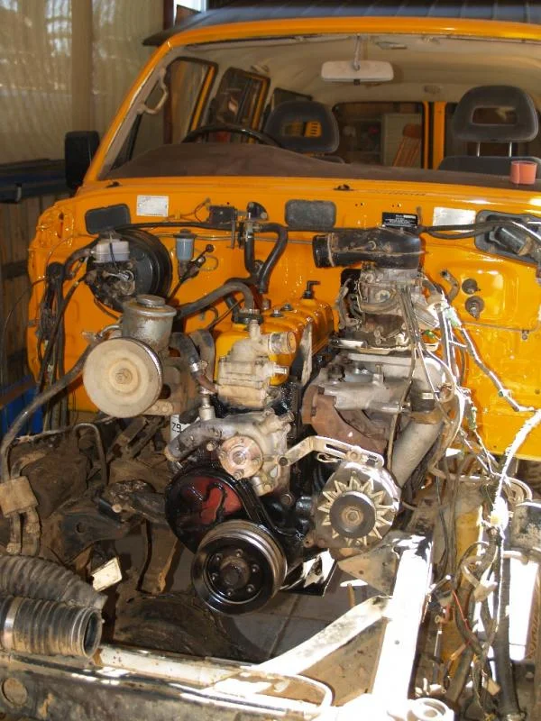

I got a turbo on my 3F but I havent tested it out yet cause the car been in full respray and engine work

Where are ya'll finding these turbo setups?
tclark is offline   Reply With Quote

This one in first post is for sale here in South Africa and made by a company "Alpine" turbos .
I see the one tclark has is a post-carb setup and the one I can get is a pre-carb setup with ( what looks like a ) Dellorto carb .
It is on sale for R7500 ( roughly $1000 ) . I think I would rather get a TBi conversion or some other eFi conversion first .

How in the world will those 2 manifolds fit together? It certainly looks like the ears would get in the way of each other. Maybe it's upside down?

I found someone who ran one of these turbos with the Dellorto Carbs as in the picture.
Apparently they were very high on fuel consumption .
After reading a bit wider is seems that a turbo needs to be combined with eFi to make it run well .
So I am going to buy the turbo setup and see how it can be combined with TBi or a custom multiport eFi . Hope I do not burn my hands in the process .
