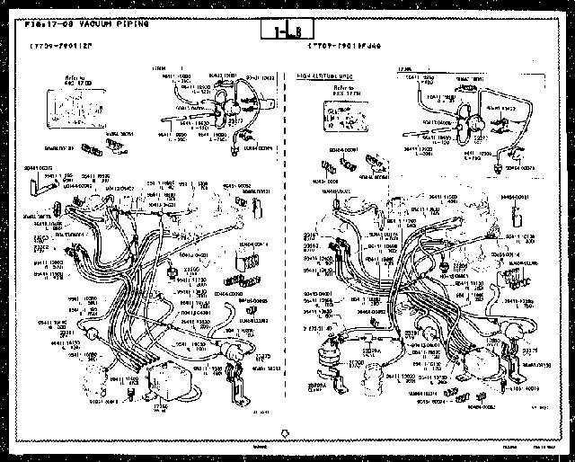

Vacuum line schematic or diagram
I was wondering if anyone has a vacuum line diagram or schematic for a 2F engine, or at least a link to one somewhere? I think I have some lines either connected incorrectly. I actually found one this weekend that wasn't connected at all. I have no idea where it goes. Anything of this nature will be greatly appreciated.

Sorry its an old thread but I'm kinda stuck. Anyone have a vacuum diagram for an 84 60 w/2F? There are no underhood decals.

There are some at these links, or search, because I know someone has posted a picture of the underhood decal.
http://www.sweetillusions.org/toyota/6.pdf
http://www.sweetillusions.org/toyota...um_routing.gif

YOU FRIGGIN' ROCK!!!!
That first link is EXACTLY what I needed.
