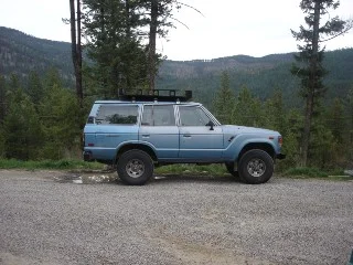

here it is
Here is the new cruiser.

btw, good looking cruiser! i like the color

My 60 is that color too. In fact it looks just like that, I better go check the driveway...
