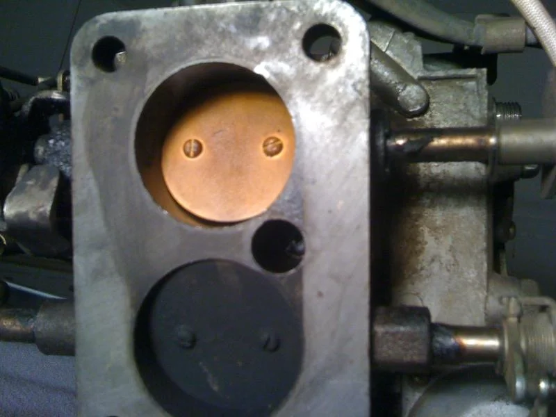

I bought my 1987 fj60 a year and a half ago. When I drove it home, it wouldn't idle at all. If the rpms got below 1500 it would die. After messing with the mixture screw and some other tinkering I finally got it to idle, but really rough. I decided to do a rebuild but im not quite sure what im doing. I pulled the carb out and one of the barrels is totally black with caked on carbon. Is this normal?

It isnt even worth messing with them any more just get a new one and be done with it.

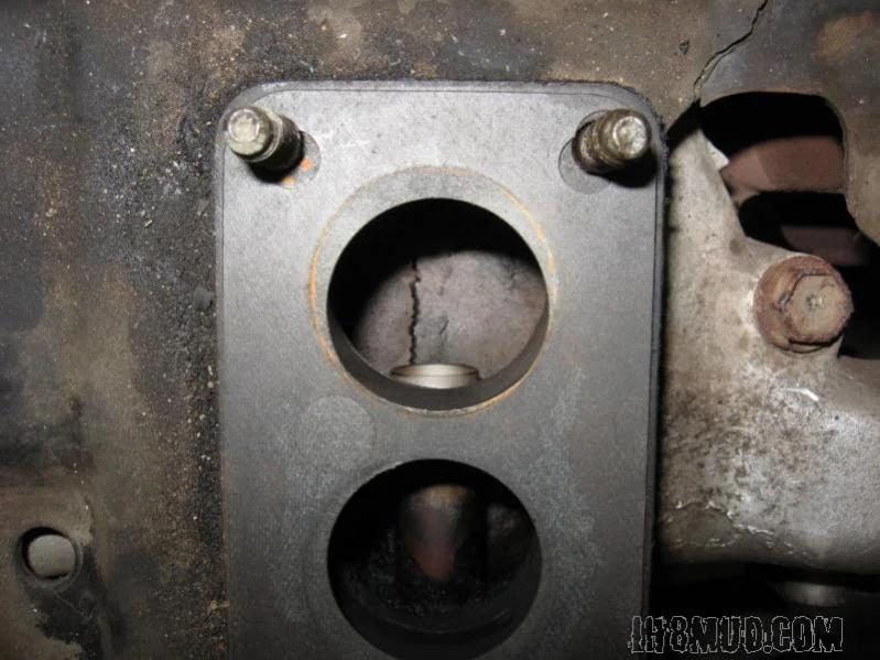

Look into the throat of the intake manifold... Is there a crack at the bottom ?
Like this (may just be a fine crack)

thats a lot of carbon / soot build up.
I rebuilt the carb in my 2F myself and currently putting back together one from an F engine. not hard just pay attention.

I'm hope not!, I'll be sure to look in the morning and let you know.
