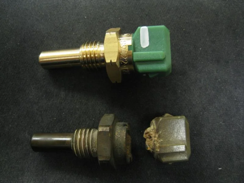

If you look at your water pump and water housing, there are three electrical connecters and on connector with 2 vacuum lines on it. The vacuum lines are top left, one connector is top left, and two connectors are low on the right, on the pump housing under the hoses.
Well, the top left electrical connector is bad; I was just looking at the truck and making sure things were where they should be, and the wire was so frayed that it just feel off the connector when I touched it. On the bottom right, the green connector closest to the engine just spins on the sensor, and I can see wires frayed in there too. I did not disconnect any vacuum lines other than 2 on the water housing to do the job, so those are all fine. But, the sensors, which I believe are part of the cold start system, are toast.

just so you know
This part, if it looks like the one on the bottom, will indeed make your truck run rough. It is the water temp sensor for the cold start system, and mine was FUBAR, as you can see.

They and the wire itself goes bad often
This is good to know. Thanks!
Can you clariy if this sensor, if bad, will it make the engine idle fast, or rough, or both?
