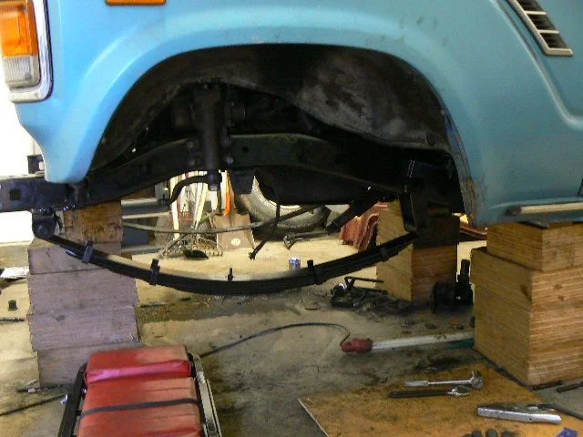

It will work. The axel will travel forward and backwords more than typical because of spring design. The spring will sit with the front high causing the tire to travel back and up at the same time. If I ever finish my crusier it should ride smooth with the shock of hitting things traveling back slightly and not straight up. The driveline slip joint gets a work out and I might need to trim more fender than typical. A cut and turn is required and the diff side spring mount was difficult to get right because of spring angle. I don't think its any more work than usal just a little different.

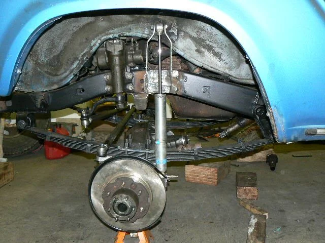

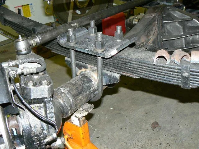

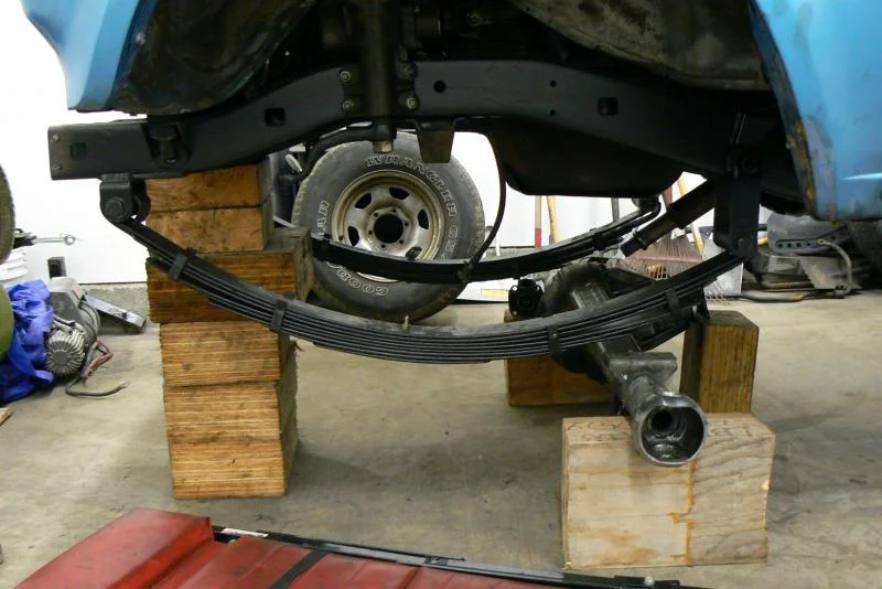

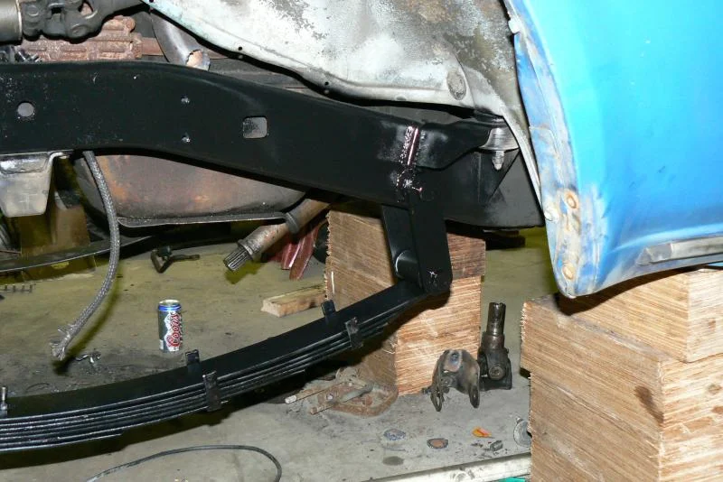

more pics

Damn, that is a clean frame. Nice install!

nice cut and turn, hopefully when i get my new 60 i can do it. it looks like in the picture that the angle after the shackle rev. might be unfavorable to pinion angle once its all done? that true?
