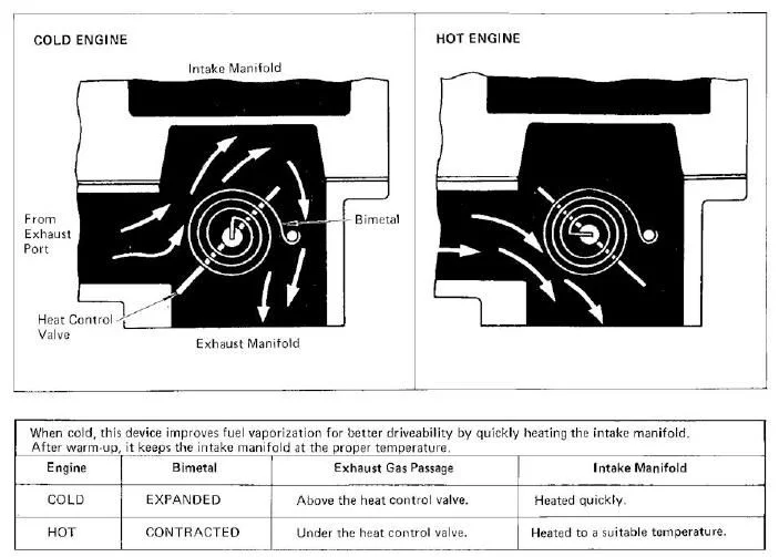

so the original poster is finding exhaust coming out from the heat valve which sits in the exhaust manifold directly underneath the carburetor. This is a flap that is moved by a bimetal spring. When the engine is cold exhaust gases are directed to heat the air inside the intake manifold and when the engine is warm, the valve moves to direct the exhaust gases away from the intake manifold.
This is not the HAI valve or inlet tube which gets hot air into the air cleaner by collecting air from around the #1 exhaust port
The shaft on the heat valve doesn't really have a seal. It's just a shaft through a bushing, especially on the front side (the side with the bimetal spring). Some leakage might be expected. If you have a lot of exhaust leaking (and it's not from something else like a crack, etc.), then I would begin to suspect that you have excessive back pressure in your exhaust system.

I suppose the heat valve could be stuck closed, but I don't think that would cause the leaking. when the engine is cold, you can try and rotate the end of the shaft to see if it's stuck.
Pretty much that only thing that would cause back pressure in the exhaust is the cat, the muffler, or a collasped pipe. If your muffler is new and no cat, then that's probably not the problem.
With that information I would say that the leak is probably a red herring and your problem is unrelated.

that image def make me think its not the riser blocking flow... when done with work im going to see if i can find an intake leak somewhere. guess im gonna have to check compression too.. hopefully its not something really bad.. im open to any advice.
