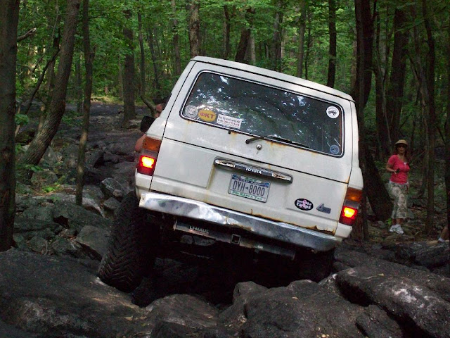

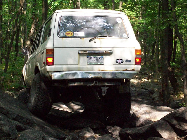

It uses the 4 factory holes, two of which are where the factory tow hook is, two same spot the other side, and one forward of each of those locations on the frame that you have to drill yourself. Here are the best pics I have of it. If you want more, let me know.

From the pics, and your mounting description, it sounds almost identical to the Draw-Tite 75025.

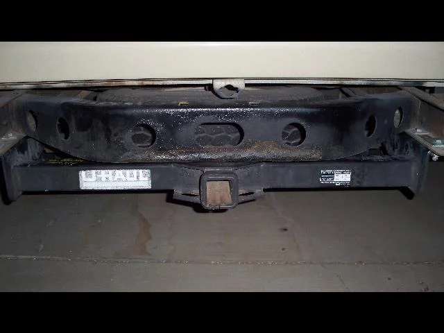

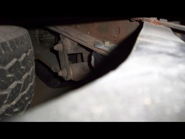

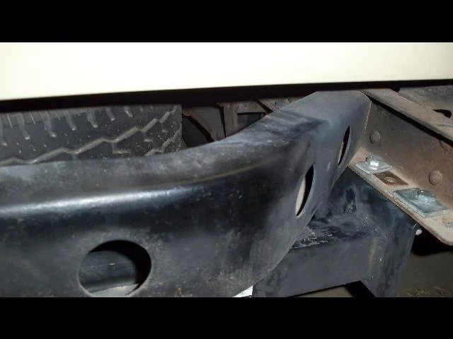

Uhaul hitch photos - Installed on 84 FJ60
Just finished installing, and as mentioned, its 4 bolts to original frame, and 2 to drill. My local Uhaul guys must hate me, and will probably turn away any further FJ60's in the future for the amount of time it took to drill those two holes.
I took care to mention it was made of unobtanium (steel, for those who only have new cars) but it took close to an hour, 2 drill bits, and the eventual use of a steel spike and 3lb sledge to make those two holes.
The inside frame member that you or your trusty minion will have to drill through is two layers of steel. For some reason, the top layer simply kept rising higher, and the drill bit couldn't bite.
Once done, its a simple bolt in. Uhaul has both the hitch and wiring kit (cause we have amber 3 bulb brake lights, they steered me to a electronic kit rather than just plain wire) that cost me under $20.00.
You can see where it is right under the frame member, and its actually not any lower than the standard tire, though for the off-road folks it will change your angle of departure....YMMV.
This unit came off of an 86 FJ60 at my local pick-n-pull yard, and with the exception of the two holes, was completely within my DIY install capability. My rig is an 84 FJ60, so I expect the hitch is the same for all FJ60's, though not sure if it would/would not fit an FJ62 series as easily.
