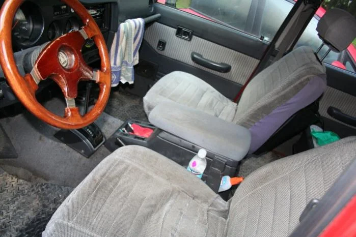

Seat and console options. I have these seats, love 'em, almost direct bolt-up.
http://forum.ih8mud.com/60-series-wa...r-install.html
