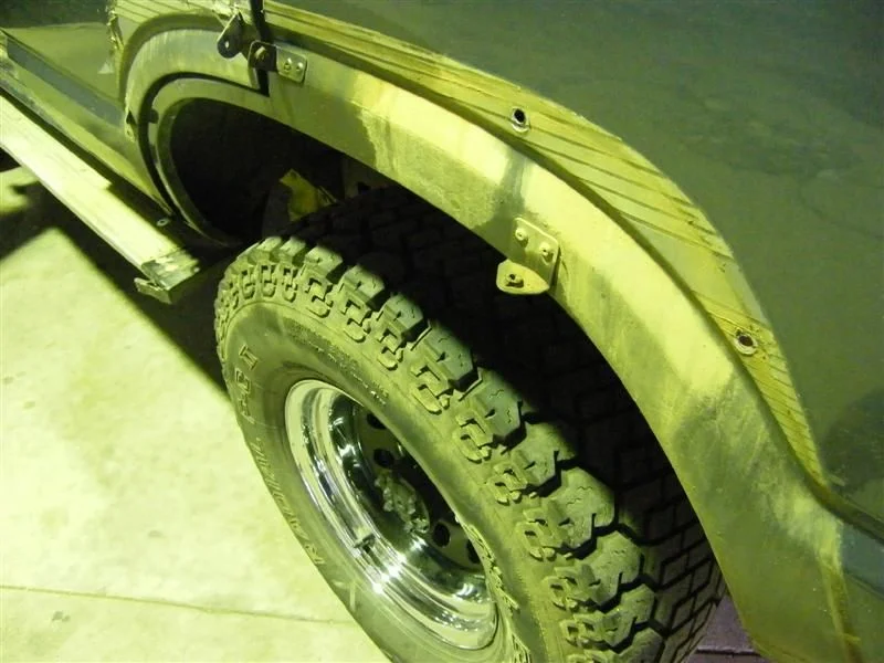

Looking for some insight from any of the folks from the Southern Hemisphere on this one. I've got a set of fender flares for my wagon that are made for the 60 series (they're marked HJ60 on the inside).
Since they aren't common here in the States I'm looking to see if anyone can give me some info on how they are installed on your rigs. The more detail the better in terms of attachment types (rivets, screws, bolts, etc), and pictures would also be appreciated of how they mount up and look when finished from the inside of the wheelwells, rear doors, etc.
Pics of mine are attached as a reference.

Hi Alpine, Those flares you have are not factory flares, they are an aftermarket copy. To attach these go find some big aircraft rivets to mount them with. I usually superglue a rubber strip on the top lip that goes against the body work, then push the flare up tight against the fender lip and drill and rivet. No more then an hour to mount all of them.
If these were genuine flares, there would be moulded mounting bosses in the flare that carry a 10mm stud that mounts to the body.
Hope this helps.

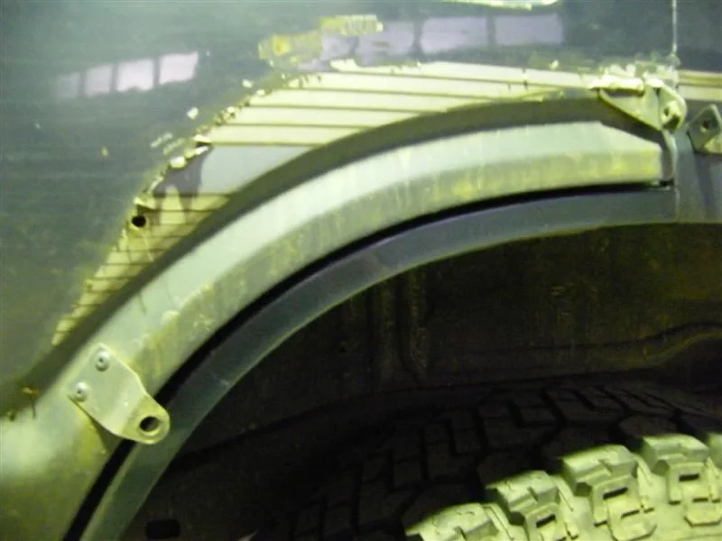

Alpine ive spent some of today pulling all mine off as part of the stripdown for a overhaul and respray,i can take some photos tomorrow of the brackets etc left on the car.
The truck is a hj61 with factory flares,ive pulled them off as tomorrow its off to the panel beaters to have the sunroof welded in,i have couple to repair so i thought i could repair them while i wait for the truck.

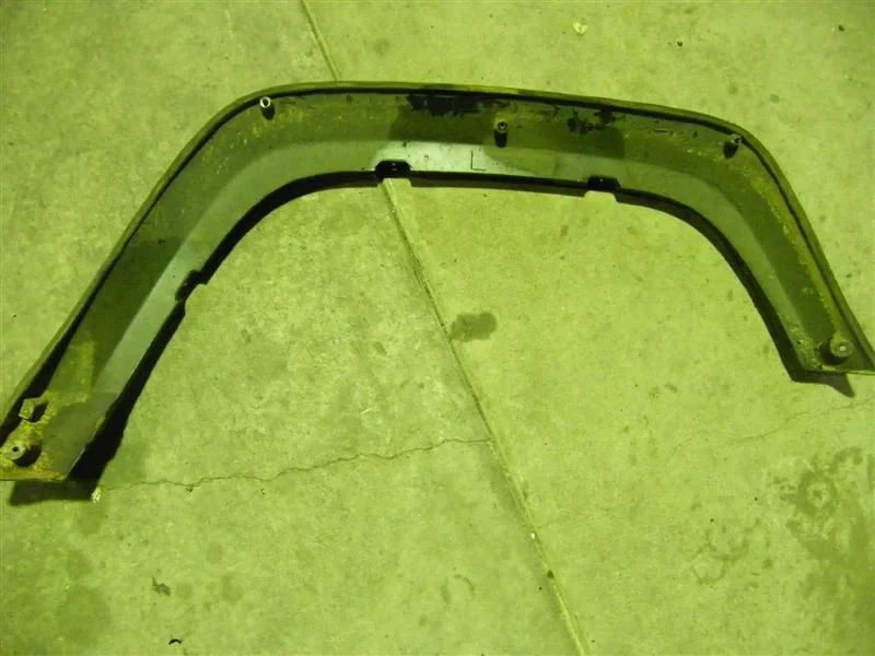

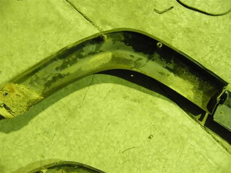

a few more

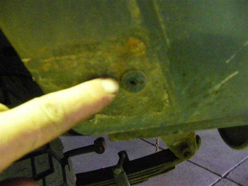

last couple

So mine are factory,i think yours are made by a mob in QLD,i forget there name,the brackets you may be able to do something similar with,each end of the flares exept the short rear one has a self tapper into a plastic grommet/nut.
Mutely was on the money exept for the brackets but i don't know how your gonna get a couple of fixed points through the body panel without any bosses as the factory ones have.

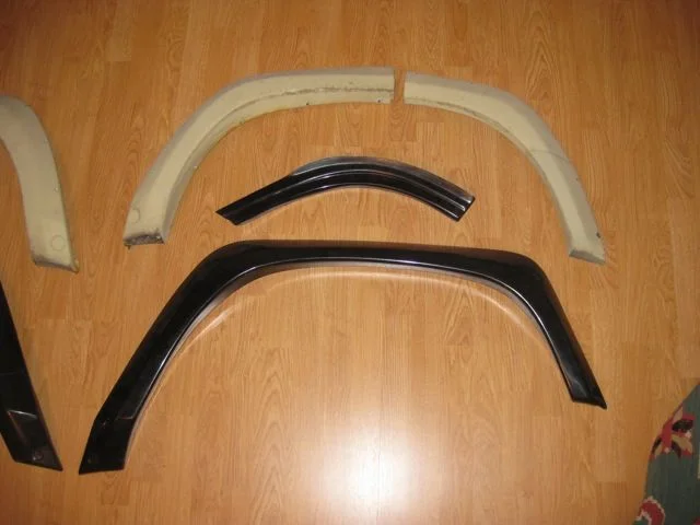

Goldchaser - one last question - on your factory set, is it three pieces in the rear on each side and one piece for the front?

2 on the rear,that smaller piece in your photos,may go inside one of the rears?

Yeah, it goes on the inside to close the gap between the inner door and the back edge of the flare mounted to the outside of the door.... I just can't figure out a clean way to mount it so that it looks nice. I'm having the whole rig repainted after the new year so I may leave that little piece to the guys at the body shop to mount and sort out. I'm sure they could make it look nice with a little body filler and paint once they have it in place.
