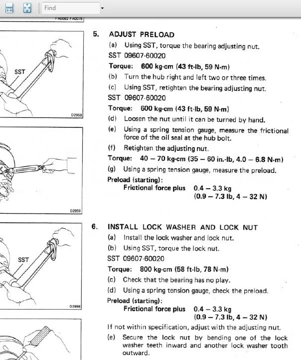

This is from the FSM,

The adjusting nut is 3-5 ft lbs. However, I just go by feel. Then the lock nut can be torqued to about 50-60 ft-lbs.

How I do it too. For the first time ever last night I checked the results with a spring scale. I'm a bit over the FSM's range.
These are big bearings, you're more likely to do damage from under tightening them than you are from over tightening them. When I've had the wheel bearings opened up for what ever reason I always pull over and check the wheel hub temperatures after the first 5-10 miles of freeway driving.
