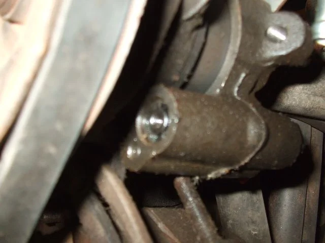

I just put my engine all back together and got a new ps pump. When I fired it up in noticed a leak from the pump and after further investegation I noticed it was missing the cap to the flow control valve. Does anyone have any ideas how i can fix it?? any help would be great

Post up a pic.

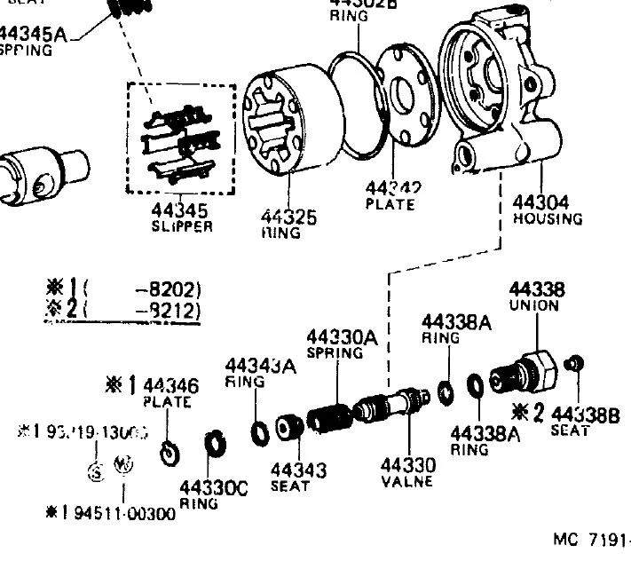

I thinkmost of the small parts are still available from Toyota:

Its the small circle cap that is screwed in by a small phillips screw at the bottom right kind of behind the pulley. (P.S. alaska when i turned my wheels it worked great it's just that cap)

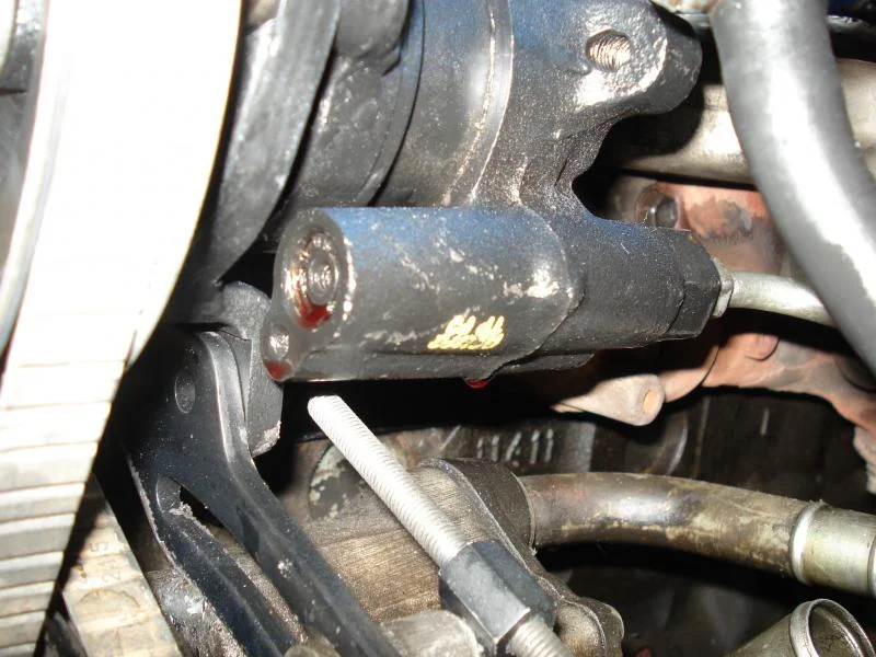

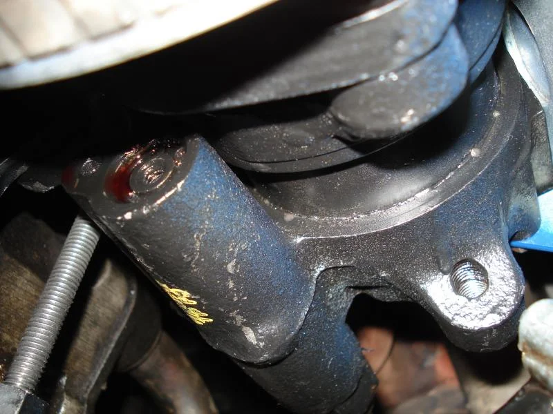

This is the cap i need or need to find a fix

there is not a cap that goes there. It's supposed to be sealed inside with an o-ring, which apparently is leaking. If it is a new pump, take it back and get another one.

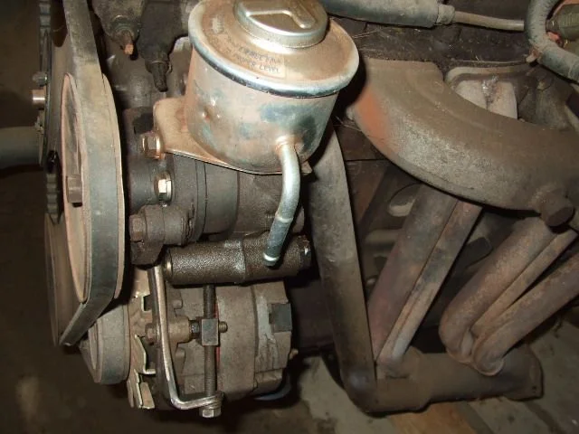

Here is what my pumps look like. The mounted one is a new one from Cruiser Dan.
The bottom one is one that blew its fluid for the last time.

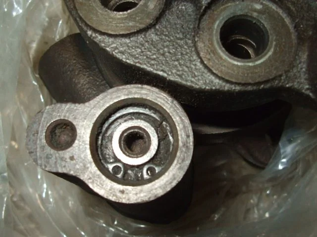

The general thought is that rebuilt pumps suck and only last a short time. I believe this is due to a front bushing that wears and is not replaceable. My experience (which I think is common) is that my rebuilt lasted a year and was leaking again.
So, to really fix it, you need to buy a new pump from Toyota. Not sure how much they are, but it ain't cheap. I went the other route and upgraded to a Saginaw pump. I say upgraded since I think it is better than the stock unit. Much more boost, which is appreciated with larger tires. HTH.

Buy the rebuild kit and rebuild it. Did mine last month and it works like new.
All aftermarket pumps are crap and as far as I know all the toyota reman's are no longer available due to bad quality control as your probably aware. Follow the FSM instructions and you'll be all good with a rebuild .

But does the rebuild kit address the non-replaceable bushing mentioned above?

No, it does not address the bushing. I called Cruiser Dan today about a replacement pump for my '79 FJ40....no dice.....discontinued. He said he can still get the pump for the later 40's and the early 60's.....what are the differences (he wasn't sure)?

The pump is not considered rebuildable due to the bushing issue. This is from Spector's site:
Rebuilt Power Steering Pumps
Specter does not offer rebuilt power steering pumps. The original Toyota front pump body does not have a replaceable bushing in it. To rebuild the pump correctly, the housing needs to be machined for a bushing and the bushing needs to be honed to match the pump shaft. Rebuilding these pumps this way would make the cost of the remanufactured pump comparable to the new Toyota pump.
Of course, people can do what they want. And you may fix it if the front bushing was not your issue. But you'd be living on borrowed time. JMHO.
