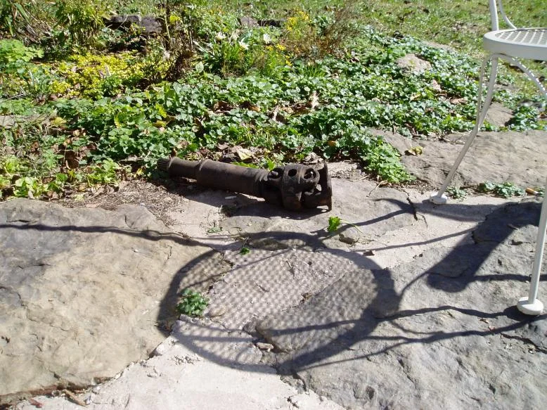

Quote:
Originally Posted by dgangle View Post
The 82-84 DCDS's are getting hard to find and pricey. Of course whenever this subject comes up someone invariably chimes in saying they can buy 'em all day long for $25 but never produces the proof.
should i put this back in the garage?

Quote:
I'll give you $25 for it. All day long.
