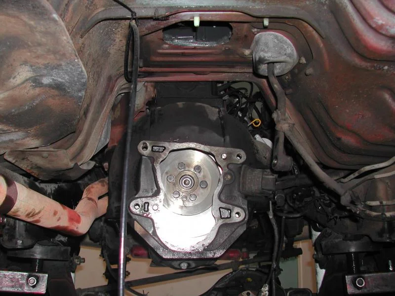

This will show the bellhousing left in place, and just working around it
