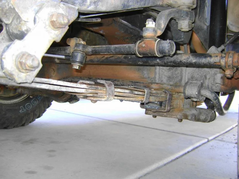

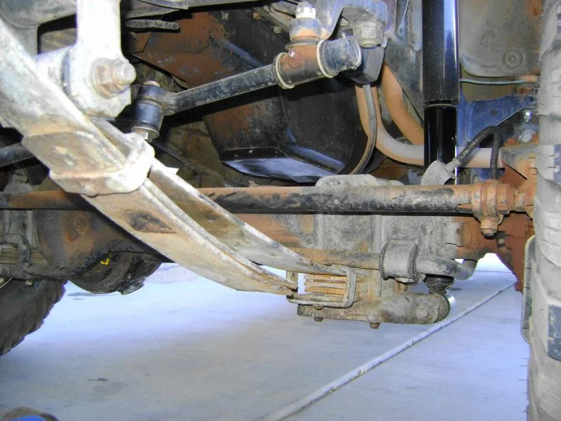

I noticed a marked increase in steering column chatter while driving offroad on a week-long elk hunt. By chatter, I mean the darn steering wheel jumped 2" up and down on washboard sections of road. Back at camp, an inspection revealed all lower leaves cracked just fore of the perch on the left (driver's) side. The leaves not pinned together are now missing the fore section all together (just plum fell out). The truck is riding on just the left front main leaf right now. I secured a railroad spike over the top leaf in the stressed area by wrapping it with a length of chain and used a bolt to cinch it tight. It stiffened surprisingly well considering the field-fix and the rig made it home (100+ slow miles) this evening.
Now the questions finally; To avoid shipping just one used stock LC spring pack, does anyone have knowledge regarding building a custom pack from more commonly avail (from a few small local junkyards) vehicles? I of course would need to match the current ride height relatively closely and I would stack them under the main leaf to avoid fiddling w/ shackles.
Anyone feel the above will just have me chasing my tail, and I should just find a serviceable stock used fj62 spring pack?
The obvious best fix would be to just use this as the excuse to go OME, but the fundage is not there at the moment. Plus, I need the rig as a DD, so I need a quick but safe temp fix.
Constructive advice is appreciated, as always.
Edited for pics: Pic #1 is after the field fix #1 removed to better illustrate the problem. Pic #2 shows my second temp fix. Relax, this is just to be able to move it around until I can get a real fix in place.

There are so many factors that play into a spring pack aside from the lengths of leaves that I'd say just find a good pack and swap the leaves in.

Agree. There have to be a bazillion stock packs around after swap outs. Just find a pair and swap them. Order some new bushings while you're at it. You need 12 and they are like $2 each from MAF.

Thanks for your opinions, and I agree it could be simpler to find a used 60 series front pack, but jy custom spring packs are far from voodoo. I know these waters have been sailed before, I just need a little help with the map

Yup D, a custom fix will be in order. I've begun brewing up something tonight. So far, it will stay SUA, be SR'd (DIY likely), u-bolts flipped (DIY definitely), longer springs (JY sourced likely), same wheelbase, etc. I want to increase ride height by 3" roughly, and end up with good caster (using a shim if needed). I anticipate being very close to needing a longer front d-shaft, but we shall see.
The rear will see comparably increased height, but with what combo I don't know yet. If I wanted to go to 5" higher, I could squeeze in a low SOA in the rear, but that won't fly at the planned 3".
I'll have to drag my butt around the local pick and pull very soon. If I get lucky, it'll only be down twice as long and work half as well as I plan

Anyway, I left for the JY this afternoon too late to do anything more than scrounge and take notes/measurements. Lots of choices as there were several nicer trucks due to C4C turn-ins, but I have a sneaky suspicion about something:
If I went reeeally long (stock was around 44" and I looked at lots of 52-53" replacements) I think the rear mount for the front ( in SR configuration) will get into the angling in part of the frame. I'm not so sure I am skilled enough to account for this angle and keep the new springs in a similar position as the current ones front to back.
I'll go back Monday am and pull 4 spring packs to build into two. I did see a set under a later Taco, (keepin it Toy, perhaps) but it was only 2 leaves with a 3rd stubby O/L leaf.
