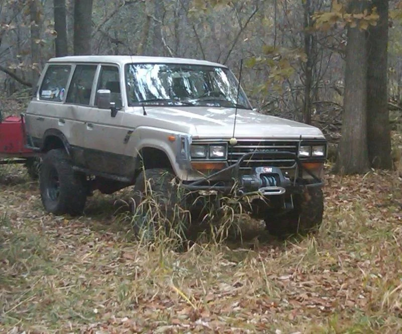

1990 fj62
Heystee Parabolic lift ~4", more like 2 on the left and 4 on the right now.
Bilstein shocks, Ford front upper mounts
Rerouted exhaust inside frame, tucked up high and quiet
A little bit of tubing and a little less sheet metal in the rockers and behind the rear wheels.
Warn 9500TI with Amsteel Blue
Scion radio
More broken lights than complete lights
not a straight panel on it
35" Kumho race cuts on 17" soft 8's with 1.5" spacers all around
Lockrite lockers front and rear
Some steering modification
front axle spun for caster
One super sweet driver's side hotrod mirror.
I'm sure I'm forgetting some crap.
Tools, spares, fluids, food, prepared for Armageddon
What I would have done differently?
Expanded my garage 2.5 stalls
Bought a 40 cowl and hood and bib and had a tube buggy built for the tight trail work and day time challenge wheeling.
Bought an 80 or Hundy for trips, family woods rides, light wheeling, two tracking, getting groceries, dawg hauling, camper towing, etc.
For now Big Stinky is going to have to suffice.

good thing you have that tennis ball to protect your grill..

It's the only plastic I haven't broken yet! Actually it was to aid CB reception and it worked. It kept the antenna off the hood. That antenna is due to come off. I use a mag mount on the roof now with MUCH better results.

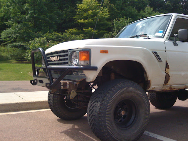

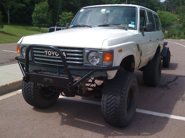

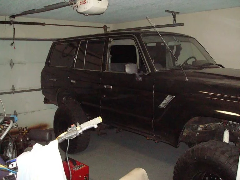

Quote:
Originally Posted by Kurtis View Post
Heres a picture of mine It was dark and the picture came out lame but you get the idea. I went spring over axle last weekend and I love it. Its sitting on 35" km2s I don't even have my shocks on yet and I still think it rides great. .
the twin to my truck it seems;-) i too rode for two months with old a$$ front shocks and none in rear, it rode pretty good. now have es9000 procomps all around, 4X4lab hysteer, KM2s, rides nicer than with the 2.5" SUA lift. Name:  Photo-0044.jpg
SOA is the bees knees, period.

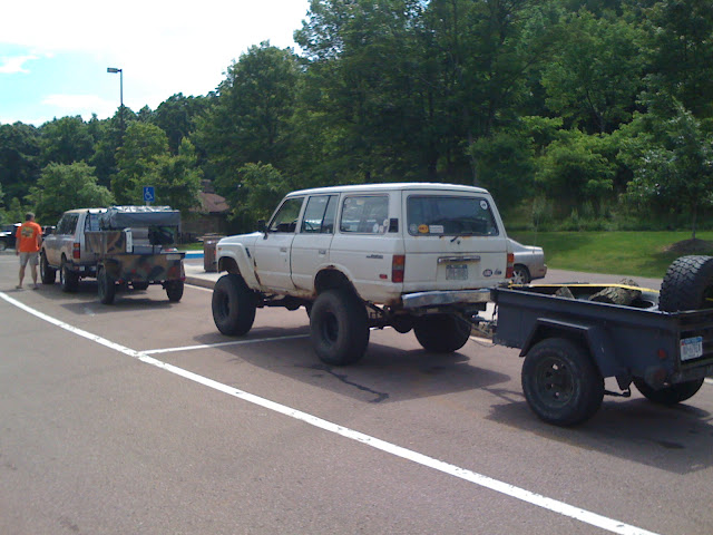

Alcan 5" lift with 35" tires, 2.5" backspacing, loaded up on the Death Valley trip with my dad and son and all the gear -
I get a little bit of rubbing on the front tires.
Unloaded -
Chad
I might eventually go SOA but I really like my current setup and feel I can carry a lot of stuff with good stability as it currently is setup. Plus I got a really good deal on this lift. I bought it used.

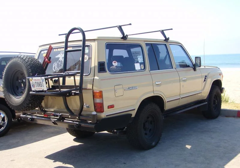

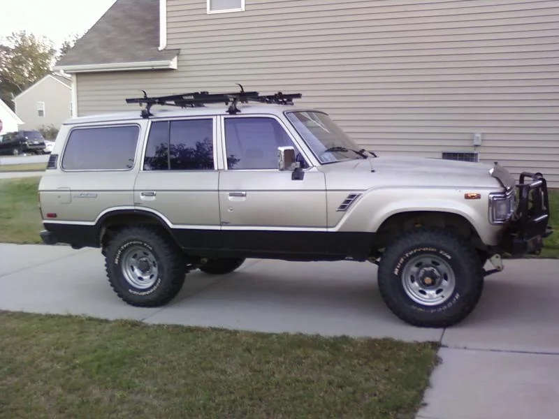

Nothing too tall here, and it's my DD when I'm in the states.
Lift: 2.5 HD OME on 32X11.5X15
Weight: 4X4 Labs rear with 3 can holder(129lbs) and SROR sliders 300 - 400 extra pounds, and will be adding to the weight with aa ARB front and 8274 in the near future.
I may add longer shakles too.
I will be at PISMO, south of the main MOB, flying The Stares and Stripe and Marine Corps Flag from a 20' flag pole.
Hope to see you there.
