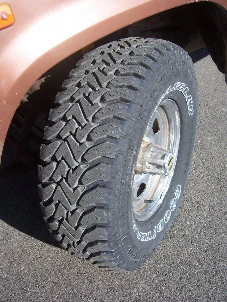

like this:
except I recently got these:

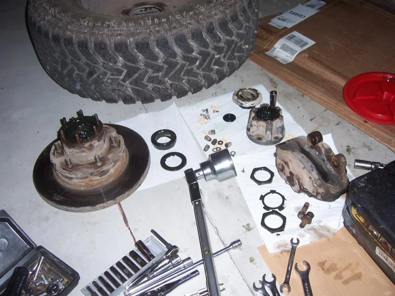

Socket depth
Hi Gabbo,
I just picked up a 54mm socket at Northern tool and was worried it was not deep enough.
It looks like the one in this pic.
Did you have any issues with the socket depth?
Thanks
Dave

Nope, it worked perfectly fine for me. If yours is the same, it should work!

hey Gabbo, you ordered from cool cruisers? When ordered did you have to specify the marlin crawler seals or did they ask which ones you wanted? And does this kit come with every bearing, seal, race, etc. you need to rebuild that whole end of the axle or do you have to order seperate kits for the different sections?
I have to do this soon and want to put everything in new at one sitting. I will prob. go ahead and do brakes and rotors as well.
Thanks and btw this is a well done post.
Oh yeah, did you have the fact. service manual and where can I get that?

I ordered from Cruiser Outfitters. They didn't have the best price I could find but it's in Utah so it shipped to me in a day. I am really pleased with them and I plan on ordering tie rod ends from there soon. (support your local economy, right?) It included everything: all the gaskets, all the seals, and new bearings for everything including new races. He asked if I wanted the Marlin seals and they weren't that much more. My kit had both new stock seals plus the Marlin ones. It even had new shims for the top and bottoms of the knuckle, but I didn't want to mess with that so I just re-used the old ones. I didn't even take the top (steering arm) off the knuckle. Another thing he asked me was if I wanted which bearings. Apparently Toyota used two different kind depending on what was cheaper at the time but he assured me both were exactly the same so he hooked me up with the cheaper "Koyo" ones.
I just have a lame Hayne's manual and I really only used it for torque specs.
The only other thing I used was that exploded hub diagram so i would know what order the seal on the back of the knuckle went on. (metal thingy, rubber thingy, felt thingy, two metal half thingies, bolts)
If you plan on doing your rotors I had to take the whole hub to a shop and have them press out the studs to take off the old one and press the new one in it's place. It was 40 bucks or something, but totally worth it. But I'm sure yours weren't in as bad a shape as mine.
