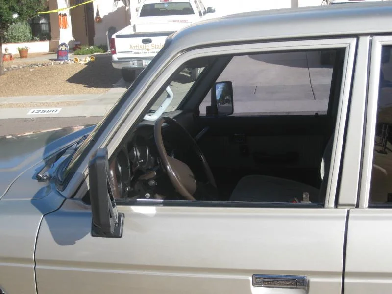

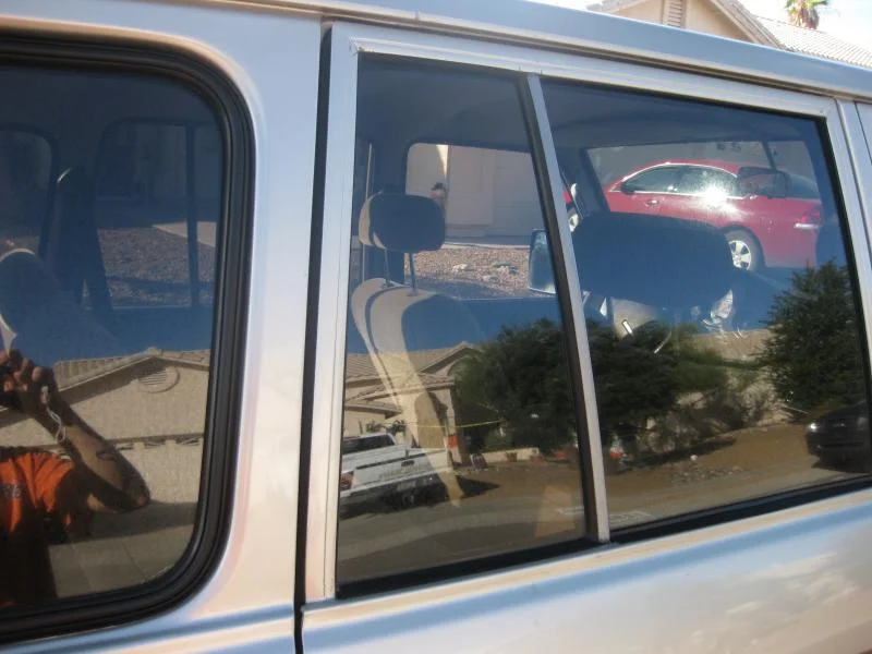

pix finally'''plus a couple of my reupholstered seats
here's some pix i took today after wash and wax.....looks good and runs like a top....now i just need nerf bars

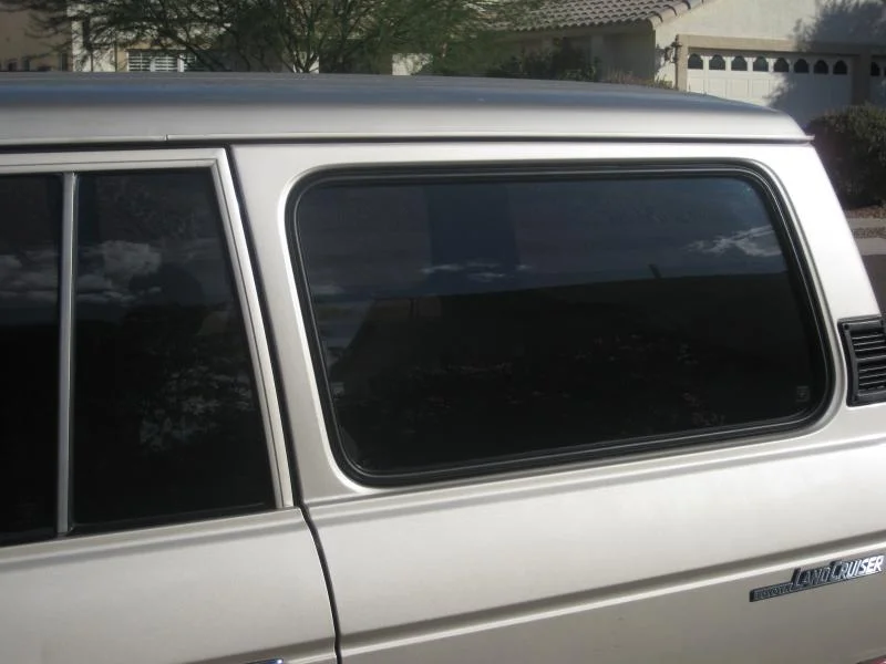

more pix
heres more

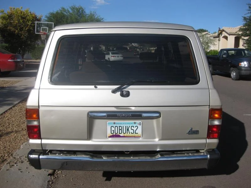

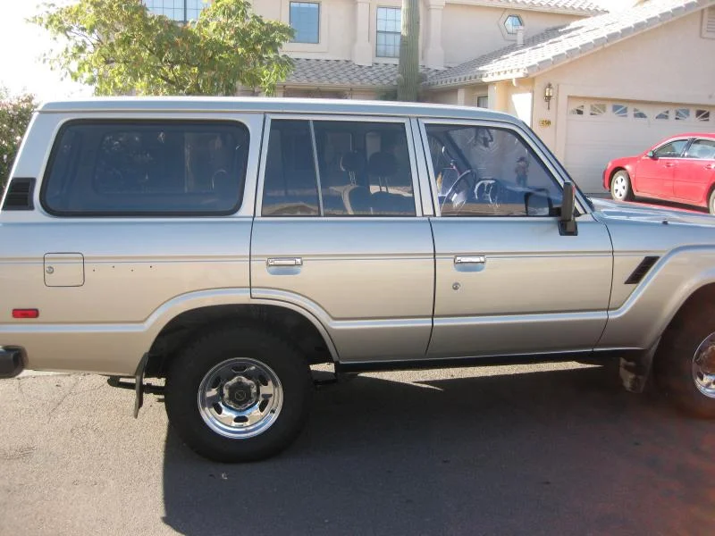

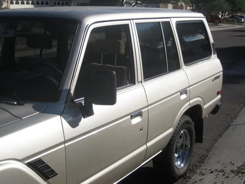

and more
and more
