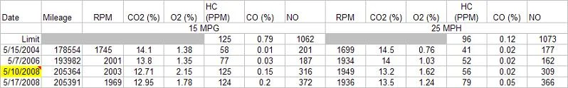

what was the measured O2? If the measured O2 is zero or low, then it could be your air pump or the air injection system. The catalytic converter need O2 to lower the concentration of the smog gases, if there is not enough O2 then the cat can't do it's job. If you have substantial residual O2 then it might be your catalytic converter.

Huh, interesting point, that could be it. What are normal O2 numbers like? O2 at 15 mph was 0.02 and at 25 mph 0.00.

Old 09-12-09, 07:02 PM   #8 (permalink)
Forum Lifer
2mbb's Avatar
here are my results for the past few tests
__________________
mbb
1985 FJ-60
