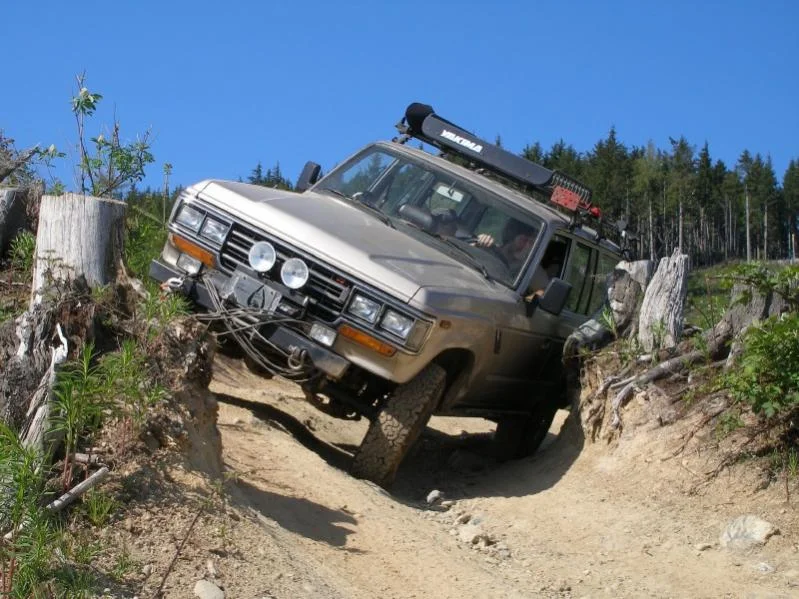

My main concern is the softness of the springs. I run my rig heavy (6000+ ready to roll and loaded with the family and the dog) and soft springs tend to put me into trees on leaning curves and side hills are sometimes not too fun. Recently we had the rig leaning 35 and 40 degrees on a run in Naches, WA.
Promise me that some of the engineering will be for loaded rigs that get wheeled. I had to add a leaf to my front Dakkars and I am going to add the DXL leaf to the rears here shortly. Will the 4'" lift require shackle reversal? Longer than stock shackles?
Tony
