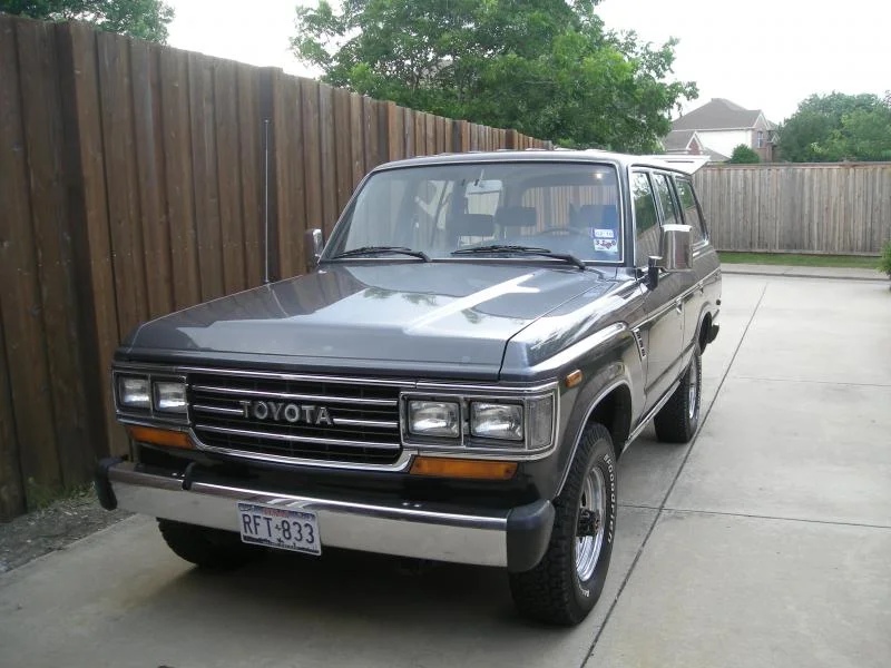

Just bought a 89 FJ 62 recently, this is my first cruiser. Its got 117k and is bone stock except for a new exhaust. I need help on a few things.
1. the first time i filled the take it overflowed and left a strong gas smell in the back right interior panel....i had to remove the panel and clean it out with soap and water to get the smell out. Anyone know what that is about? Do i need a vented gas cap?
2. Would like to replace the headliner and carpet. Any good sites to visit to order these things?
3. Check engine light - this comes on after about 30 min of highway driving. Any experience with this?
Any help would be appreciated!
