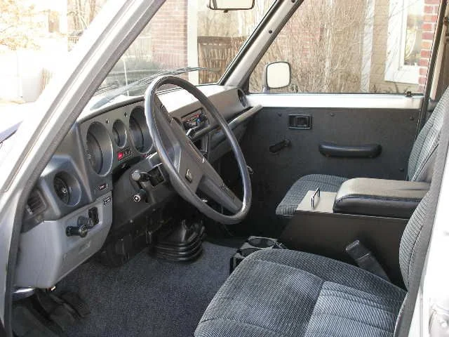

I have new mat and carpeting and reaally like it. It brings the 60 back to "Like new" condition. But, since I'm going for the "utility" look, I'm most likely go to vinyl soon.
Also, the problem with "Rhino Lining" the interior is that it doesn't cover all the exposed wiring and body shapes that is hidden under the carpet. So if you want to run power or large speakers in the rear the wires are all exposes. Plus once the lining starts getting ground in dirt it's never looks as good as when it's first sprayed.
(I learned all these lessons on a Jeep, Samurai and a utility van....)
Good luck with whatever you do!
