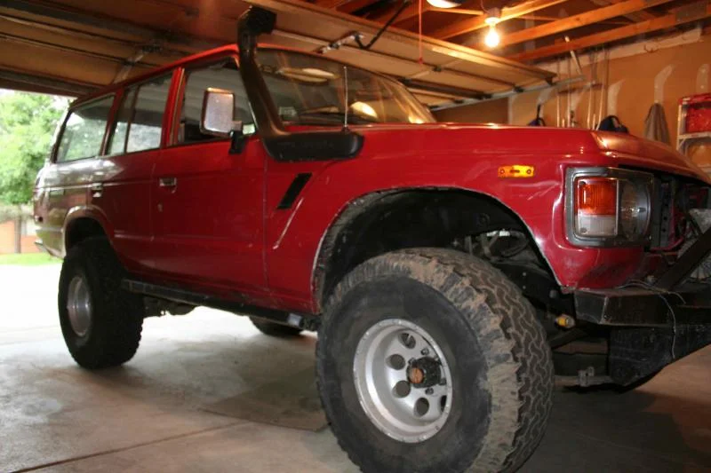

Hi all, I've searched through the forum and read a whole lot but haven't been able to find what I'm looking for yet. I'm going to do some front fender trimming to clear my 35's and want to keep the wheel well liners. How have people done this? Pics appreciated since the only body work I've done was via trees and rocks.
For a visual that's to Weak-Link for this pic.

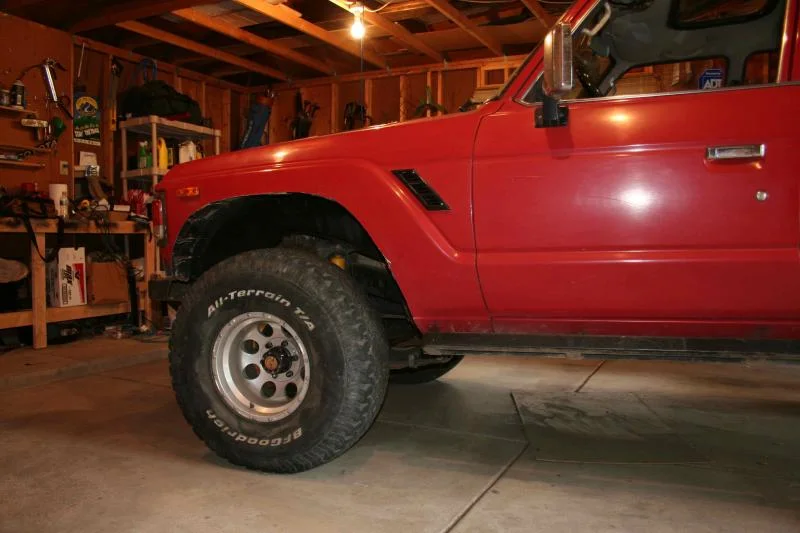

I slotted mine and used 1/4 i round stock welded to the edge worked great I could of made it look better but mines a trail beater
a little filler and it woulda looked great
5 roll over later they still look great

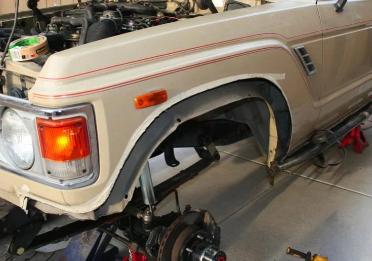

I think the 1/4 round stock is the way to go, otherwise you can end up with this kind of bodywork.
here are some pics of how I did my chop

I too used the 1/4" rod to get a clean and strong line. Here's some pics of the trimming.
Driver cut, rod shaped, tacked together.
This is before cleaning up anything.
Passenger trim
Used a hole in a frame to shape my 1/4" rod. It bends by hand.
Driver cleaned up.
Well attatched but not filled yet.
I used the metal off the pieces I cut off to fill the gaps on the wells.
Tacked the pieces in, sealed the welds with seam sealer and tried some texture and paint.

Thanks again guys for the inspiration. I couldn't decide which way to go, like weak-link or like me_tu05, so I did one side each way.
I just did the cutting & bending so they aren't done but they're well on their way.

Finished it up today, very happy with it and not anywhere as hard as I thought it would be. Thanks to everyone for the help and inspiration.
Psst, Elliot. If you're ever looking for some people that wheel come on over to Front Range 4x4 where we do lots of runs. You could even bring the Cherokee (unlike some other Denver clubs)

You just need to find someone with a fender roller to put that look back on after chopping. Any custom body shop could do it if you're willing to pay. Another thought would be welding/splicing what a couple people cut off.
My wheels? I have no idea, got them with 35" tires for $300 on Craigslist. I'm guessing they're old American racing.

Go for it Marco! I was very reluctant to take an angle grinder to mine but that's all I had. It's not the most sophisticated tool but once I made that first cut it was pretty easy and plain old fun!
Oh yeah, and I don't think I'll have any rubbing now either.
