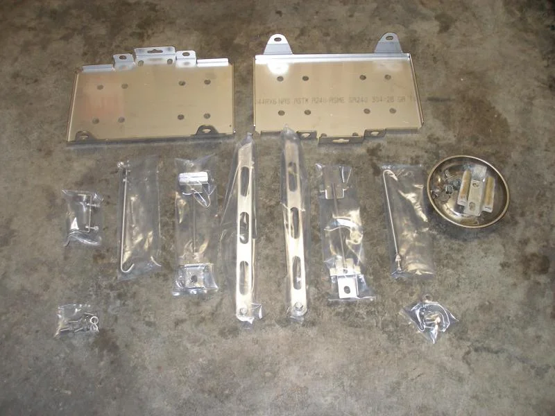

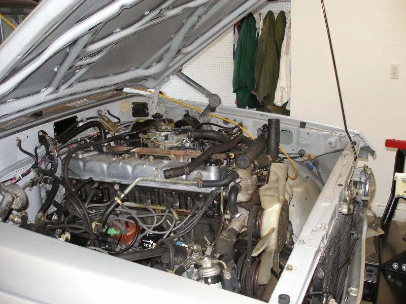

Well, I've started my summer upgrades with the help of Exrsa1. After acquiring all my parts over the winter and a healthy dose of Uncle Sams Tax return I'm conducting the next phase of improvements on my 60.
Here's a list of items/projects for 2009:
Front ARB Locker - Currently being installed
Rear ARB Locker - Currently being installed
HD ARB compressor
4.56 gears in front and rear - currently being installed
New front and rear seals
Front knuckle rebuild
Front and rear bearing inspection
New rear brakes and cylinder
Rear drums turned
New Front brakes and calipers
New Front discs
Flush brake lines
Stainless Steel lines front and rear
Remove, clean, test and boil out radiator
New rubber hoses on entire engine
Replace all vacuum lines with silicone lines
New belts
New timing cover gasket and seal
Clean, inspect and paint all front end brackets
New tie rod ends
Rust proof all interior seams on doors and body panels
Dual Stainless Steel battery holders
New Dual Batteries
New custom cut dual battery harness with rear harness for Engel fridge and front jumper cable quick plugs
Delete rear heater and engine bay hoses
Carb rebuild - Still need to locate and schedule with Jim C.
Fab up rear utility light bracket on SROR bumper
Re-do the field tool kit
And a bunch of misc. stuff.
An added note, I'm keeping the 60 smogged for as long as possible since it runs great even with 235K on the meter.
I'm hoping to have this stuff completed by August due to a planned trip to Colorado in September!

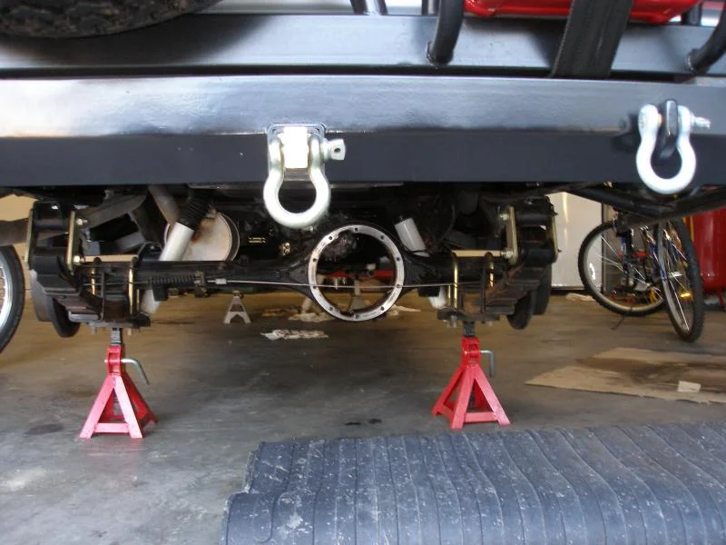

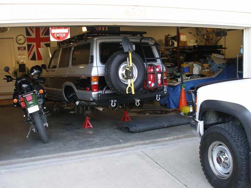

Thanks.

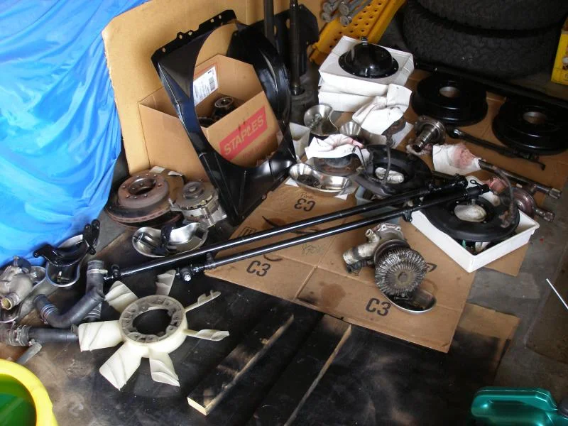

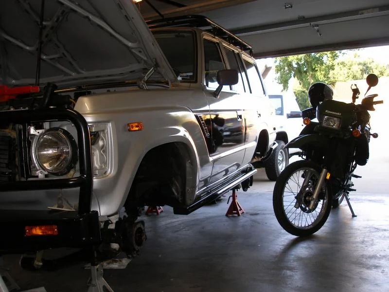

Yep, someone got my front ones and axles aswell!

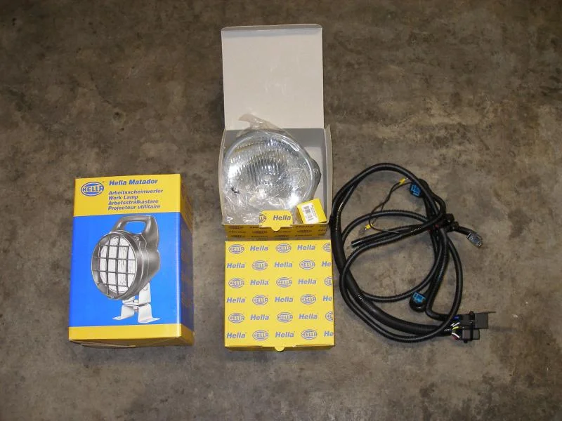

I forgot that MWalls built me a Hella M4 Headlight upgrade kit which will also get installed along with the SS dual battery trays....
I'll keep you updated. Thanks!
BTW-I'm looking for a BJ60 Airbox, here's my trade posting...LMK if you have one.

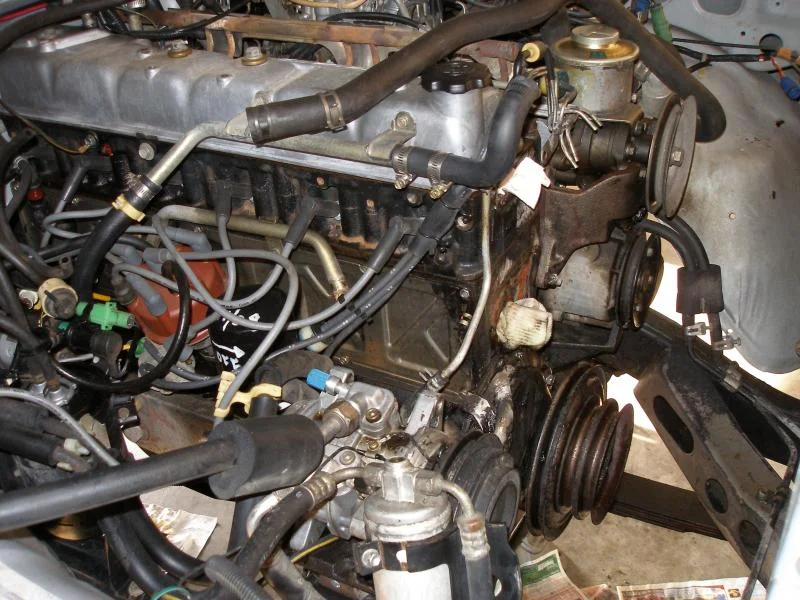

Radiator Update-
I originally had planned on purchasing a new radiator for this update but I went ahead and took the rad. to the local rad shop (I love these shops that are 50+ years old and still run by the original owner that knows everything about their operation...) They inspected it, boiled it out, pressure checked it, straightened the bent fines and repainted it for $49.00! They indicated it's still a strong rad! So I guess that saves $289 for a new one!
I'll be picking up the entire hose kick this week from Toyota, so the weekend will be fun filled!

Gunky Mess
Well, I picked up the radiator and it's all cleaned and painted and ready to go back in.
I've pulled the Alt., Thermostat housing, Water Pump/Fan and brackets. Cleaned and painted the brackets and working on the front of the engine.......what a gunky mess....It also amazed me that the original hoses are still in place and haven't blown....If anything, I'm glad that I'll get those replaced.
The 4.56 and ARB lockers will be in the mail today so we'll get those in and plumbed.
__________________
BritKLR
britklr is offline   Reply With Quote
Old 07-09-09, 10:11 AM   #30 (permalink)
Forum Regular
Join Date: May 2007
Location: Portland, OR
Posts: 123
I like that your oil filter has "OFF ->" painted/white out'd on it. Remember, "Lefty-loosey, righty-tighty!"
Eporter is offline   Reply With Quote
