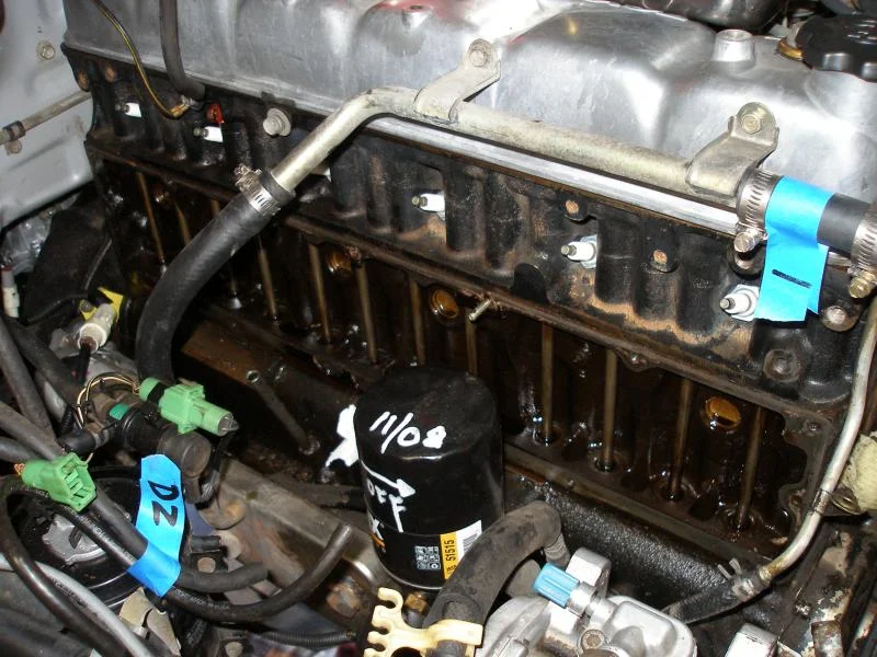

I like that your oil filter has "OFF ->" painted/white out'd on it. Remember, "Lefty-loosey, righty-tighty!"
Crap.....you saw that....I tell you, cruzer guys miss nothing!
Your right! Sometimes I get carried away.

It has a whole paragraph on there you can't see. The date/time it was changed, the date it will be changed, the temperature in the garage that day, direction to loosen, direction to tighten, initials signing off on the job, and a reminder to fill the engine with oil....... Just messin ya!! OCD!!!!
Ex

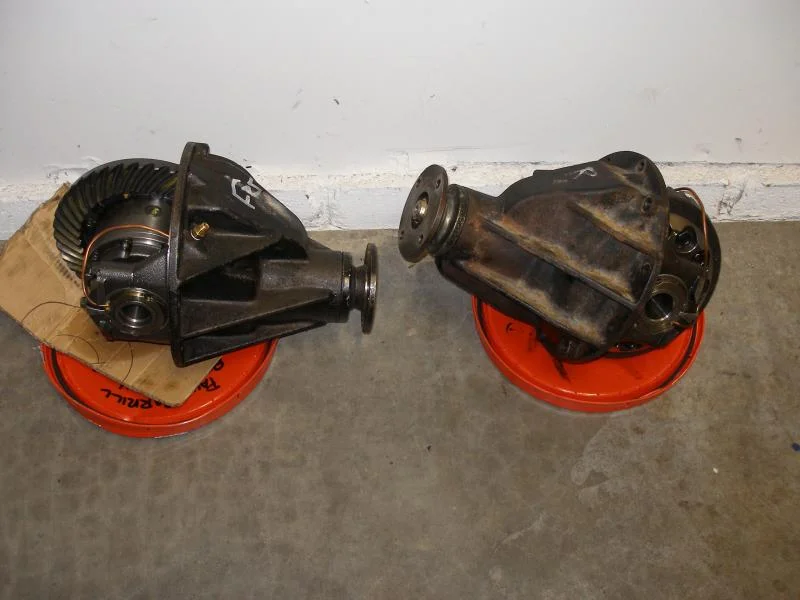

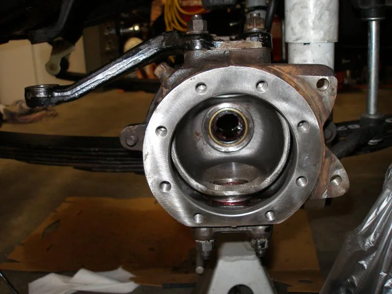

Exrsa1 came by last night and we got the knuckles rebuilt with new bearings and seals. I'll put in the marlin seals tonight.
Here's some porn shots of the new 4.56's and ARB's. I hope to put those in sometime this weekend.

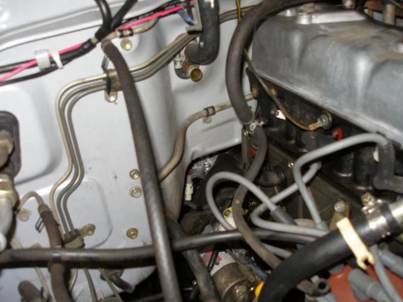

I also did the rear heater hose delete. It certainly cleans out the engine bay of extra heater hoses!

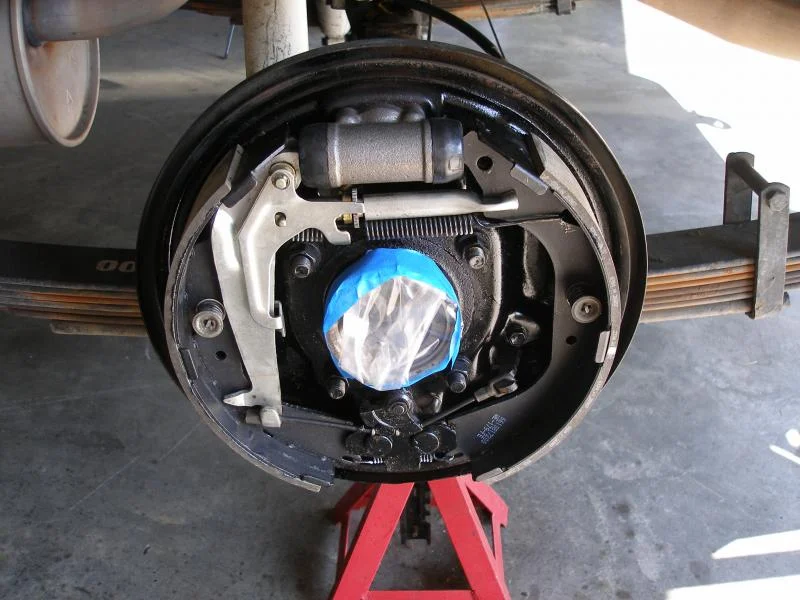

Pulled, cleaned, painted and installed new rear brakes and cylinder.
Pulled and replaced rear axle bearings and seals.
Was messing around with the airpump hoses and managed to break off a large hose coming off the EGR/Emissions stuff on the fender....lucky I have some Emission parts and managed to fix it....lesson learned-don't mess with it if it's not broken!
Sorry, no pix tonight.

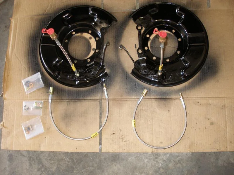

Pix
I got guilted into posting some pix.
New rear brakes
New SS brake lines
Replacing side cover gasket.......BTW, anything I should look for in there while I have the cover off?

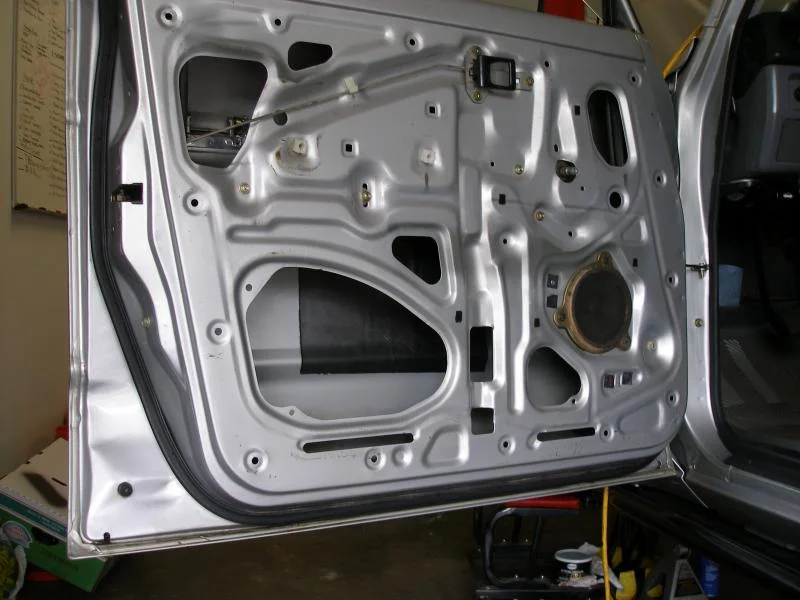

Haven't had much time to put the 60 back together due to work, but managed to put some sound proofing in the doors and rear quarter.....makes the doors sound like a Lexus when you shut the door! Got the interior panels back in as well.

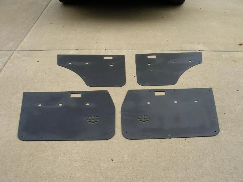

Ok you need to tell me more about the door panels. You cut to fit correct? Do they come in one big sheet? Where to order?
__________________
Here's a link:
http://forum.ih8mud.com/60-series-wa...-done-pix.html
I loled

Thanks to that same "seal friend", we got the Diff's in the front and rear today!!!
Seriously, could not have done it without exsra1!.....
Got the axles, drive shafts, rear brakes in as well!
Will button up the front brakes and start putting the ARB compressor, airlines in tomorrow....then put the engine bay back together!!! I can hardly wait...
Thanks

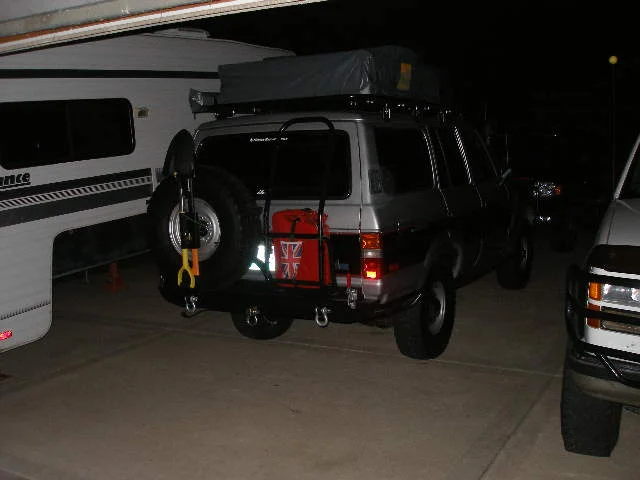

Where did you get the shovel and Axe bracket on your Spare? And what does it attach to and how?
Thanks much a great upgrade list.

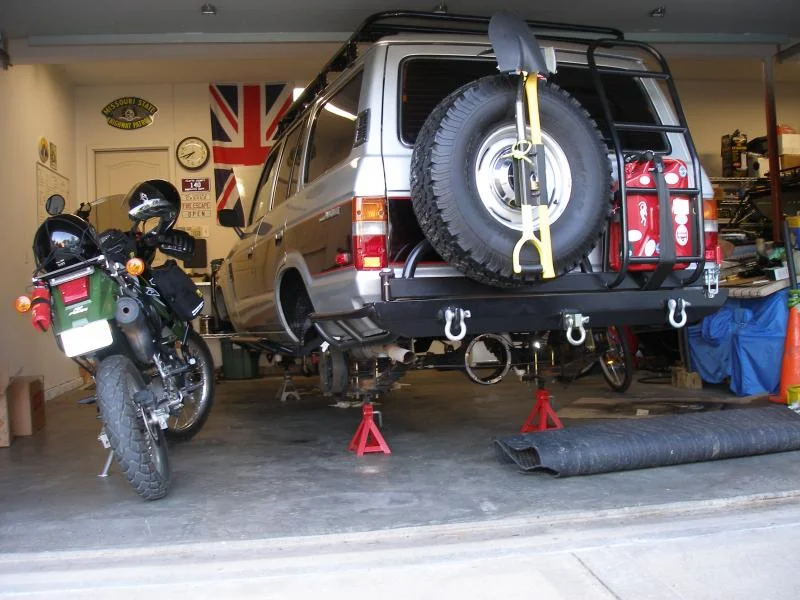

The clamp portion is a: Defender Roof Rack Axe and Shovel mount.
They can be ordered from Off Road Unlimited for $46.00.
I built a small receiver mount that is mounted to my tire carrier and comes out of the center of the spare tire. I then made a insert that bolted to the axe/shovel mount and slid into the receiver ( just like a mini receiver hitch below your bumper) I drilled a hole through both and inserted a receiver hitch lock so that I can secure the Axe/shovel mount and remove when I need to remove the spare.....
I hope that makes sense...I'll see if i have a better picture.
Good luck!
BritKLR

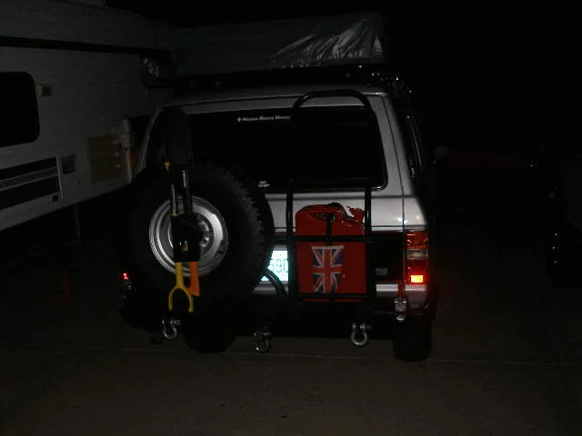

axe/shovel mount
Closer pix.
BTW- just noticed your signature line....Thank you for what you are doing and serving our county!
