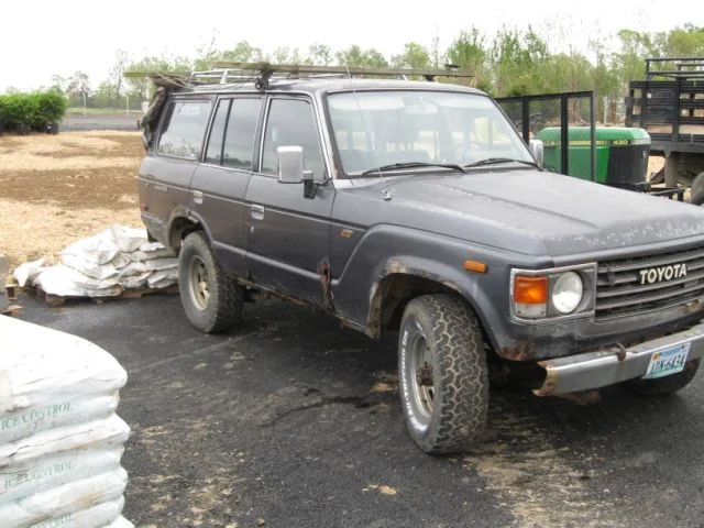

So heres what were doing:
- We have a perfect body FJ60 (TX truck - no rust) I picked up for cheap locally with a dead engine (I think it just needs a fuel pump =).

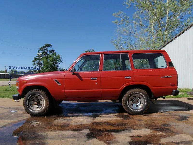

- We just bought a TOTALLY rusted out HJ60 for cheap also with a PERFECT 2H/H55F/Split case (Thanks Brad Yurish of Leesburg, VA).
- We are going to marry the good parts of these two vehicles.
- From what we hear, 2H parts are easier to get than 2F parts and diesel fuel can be purchased in 55 gal. drums where as gasoline is purchased from kids on the side of the street out of pickle jars and its often cut 50% with water.

Pic 1: The LeTourneau University Automotive Society
Pic 2: The FJ60 we are starting with
Pic 3: The HJ60 which holds a perfect shape powerplant
