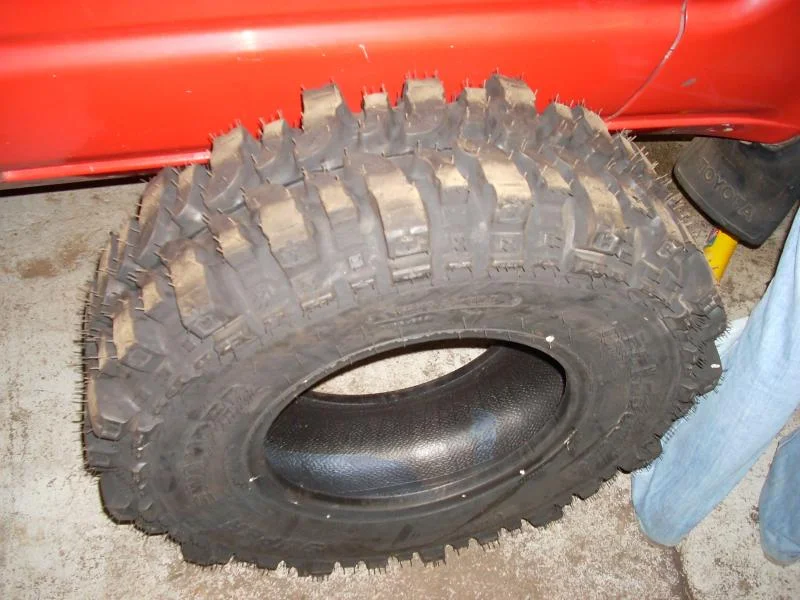

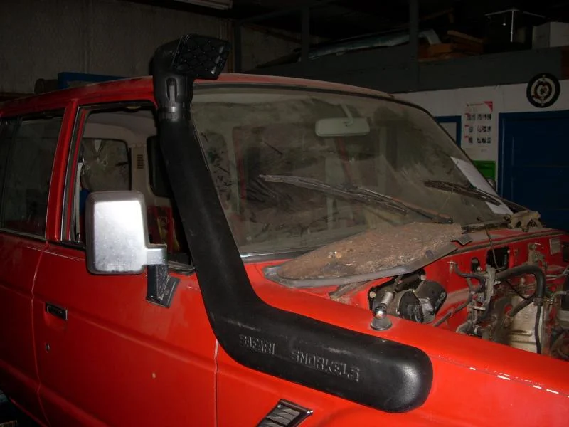

We have got pictures to come- the past couple of weeks we have been getting lots of parts together in preparation for lots of work. Some of the parts we have gotten are. . .
We just had an OME Lift kit arrive- Heavy Duty Diesel
Snorkel came with the lift
Third Members are here ( 4 11's)
Axle re-build kit is here, just waiting on bearings
We got a set of Super Swamper’s (4)
Last night our winch from Maine and Split Rims from MA were loaded on a truck bound for the shop in TX. The split rims need to be wire brushed!

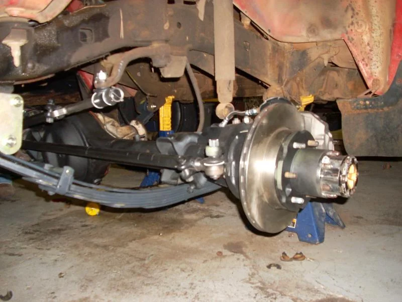

Finally, After 8 weeks of waiting, bearings from Japan come across the Ocean. For the last 3 months, no one has had Koyos or NSK's. This is one of the last things we are waiting for before we can put a big dent in the installation.

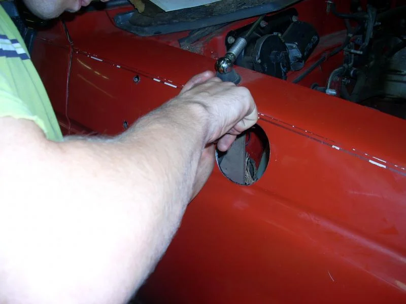

Re-post all the pics...

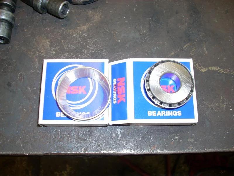

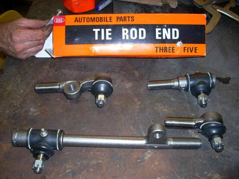

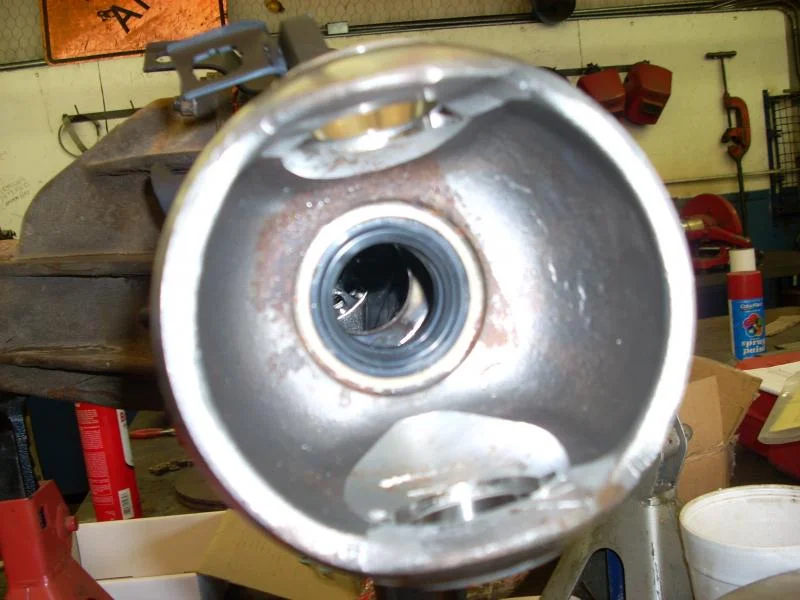

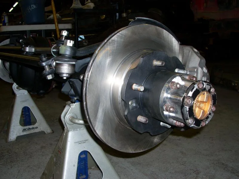

Apparently, when the MUD server went down, it dumped ALL the pics... So here we go, again...
'I discovered my wife's laptop has a spot to stick a SD card into, so I was able to pull the pics. This is the work from the last 10-12 days.
Pic 1. 555 Tie Rod Ends
Pic 2. Marlin H/D inner axles seals (a must have!)
Pic 3. We used all Koyo / NSK bearings for trunnion / wheel bearings (non of that Chinese crap)"

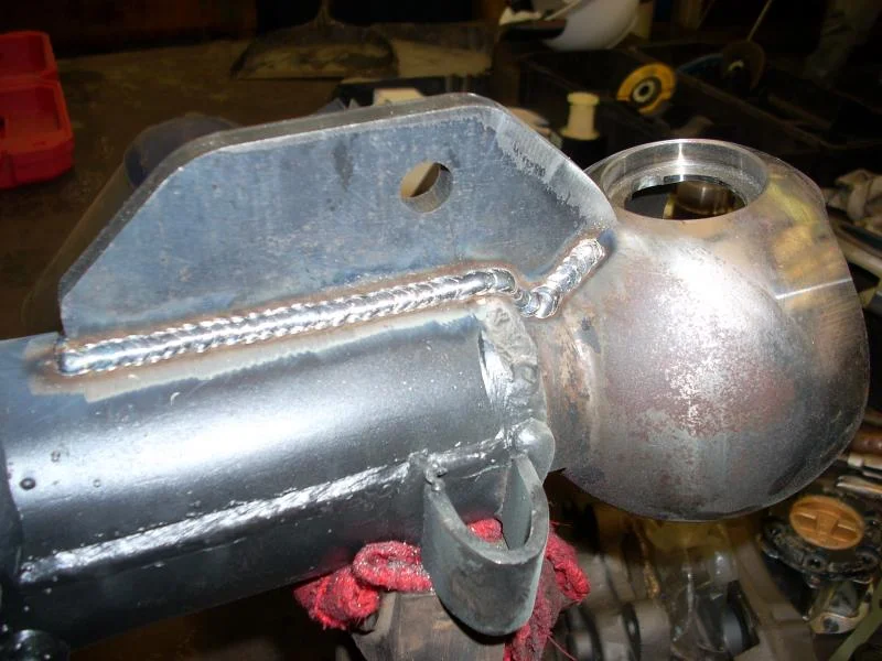

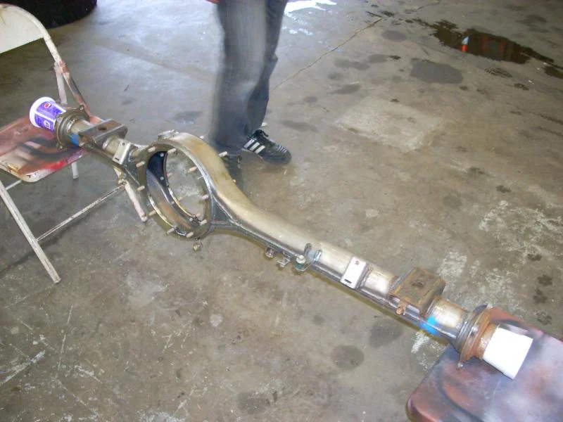

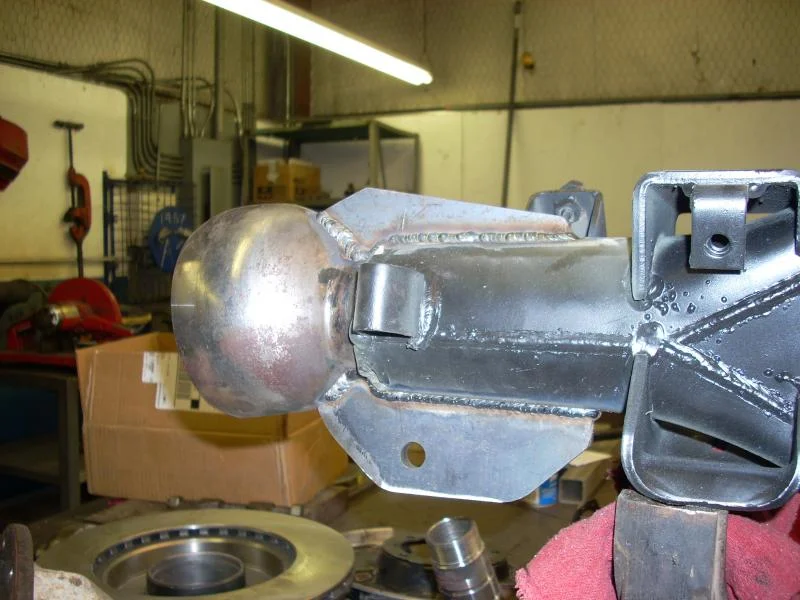

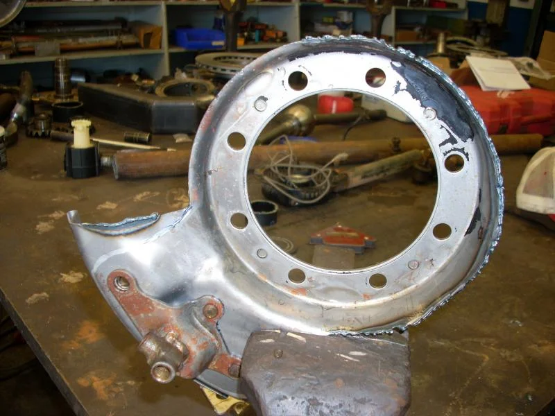

"My father in law (also a missionary in West Africa who used in own an HZJ78) said he had seen axles snap where they neck down into the knuckle-ball so we went ahead and got the Marlin gussets.
Pic 1. Cut the old brake line bracket off and flap wheeled for welding
Pic 2. Top gusset on
Pic 3. Top and bottom on"

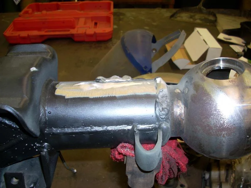

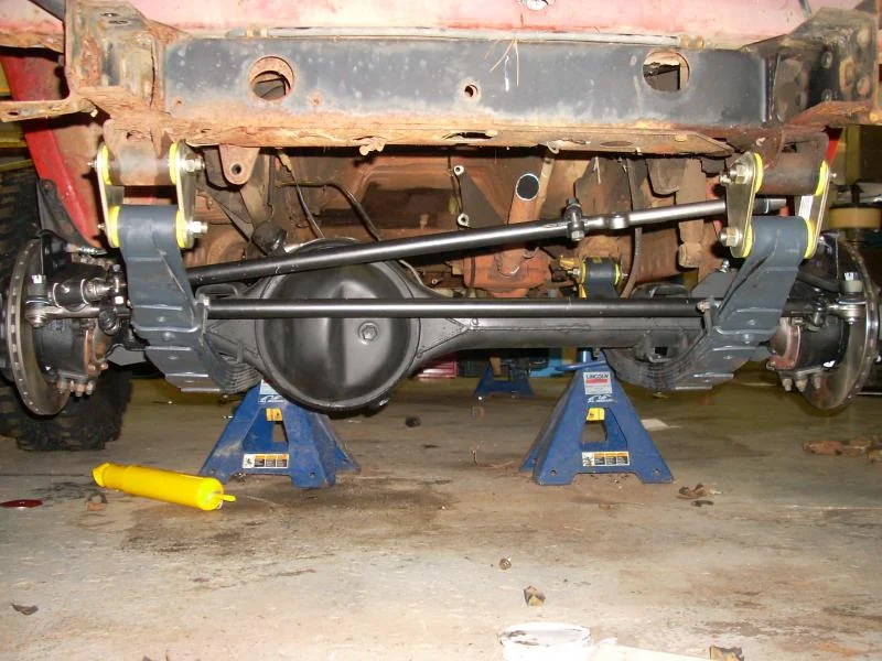

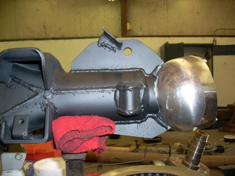

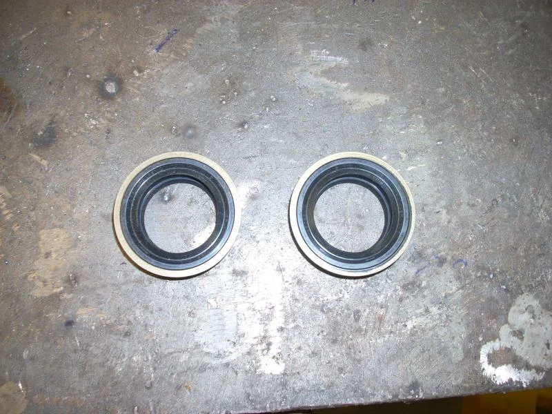

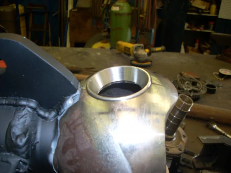

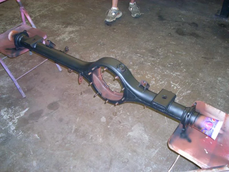

"Pic 1. Bottom and top gussets on, bump stop gussets on, and brake line bracket reattached to gusset and then painted it all with several coats of flat black.
Pic 2. Trunnion race installed
Pic 3. Marlin inner axle seal installed"

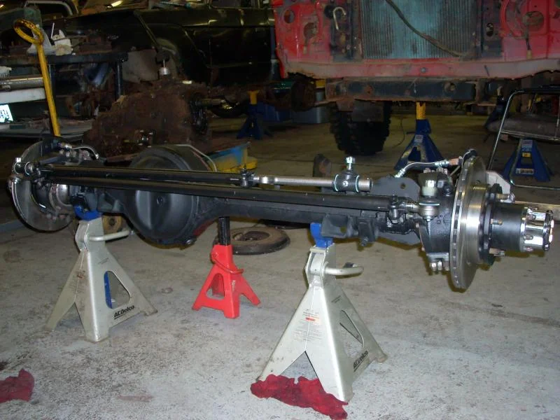

"Pic 1. Pic of what Trent and I were talking about. Trimmed the Dust covers so its only purpose is to hold the brake line now. They came out rather well all things considered; Plasma cutter and some flap wheel action and they were ready for paint.
Pic 2. Side one done. All new everything; disks, V6 calipers, brake lines, etc, etc, etc.
Pic 3. Front axle complete"

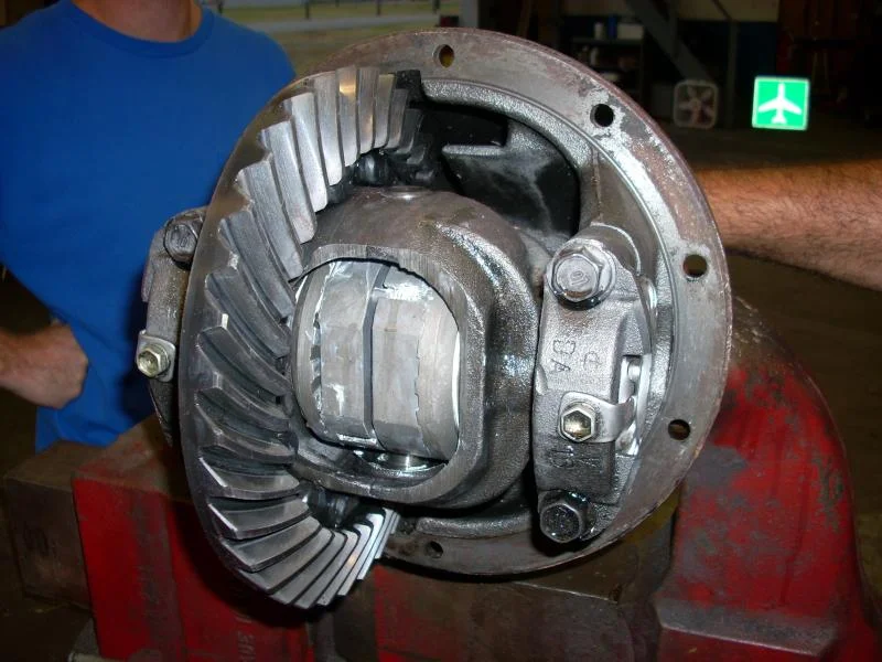

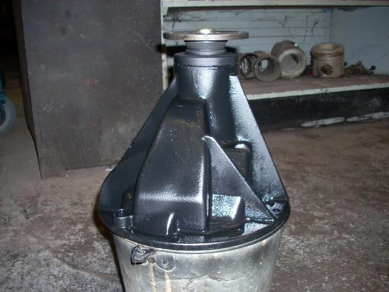

"Pic 1. Somehow I missed this one; Aussie locker in front diff installed
Pic 2. Front Old man EMU lift springs installed with axle hung.
Pic 3. Same as Pic two from differnt angle"

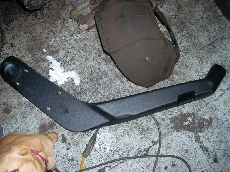

"Pic 1. Installing Snorkle
Pic 2. Snorkle on ground
Pic 3. My puppy trying very hard to get in the picture."

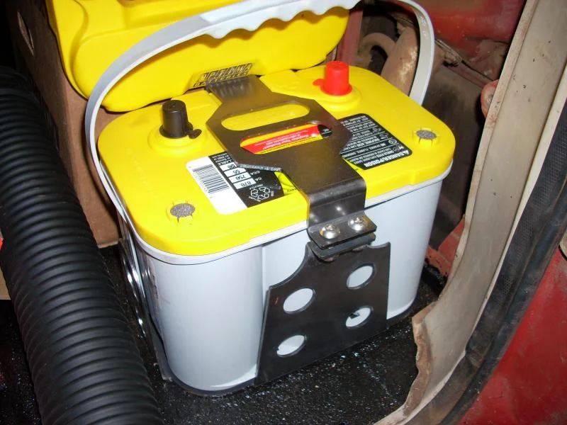

"Pic 1. Optima sold us two Yellow tops for an EXTREMELY cheap price. Ruff Stuff Specialties sold us two battery trays for an EXTREMELY cheap price too. Thanks to both those companies for their help in this project.
Pic 2. The meats; I know there have been several debates going back and forth about what tires we should use. We have decided on the Bogger 33X10.50R16. We got these at cost through Longview Driveshaft and 4X4. Thanks to those guys too!"

Waiting for rear axle parts... Hot tanked the rear axle, painted it and then cleaned and painted the 4.11 third member.

Snorkle installed...

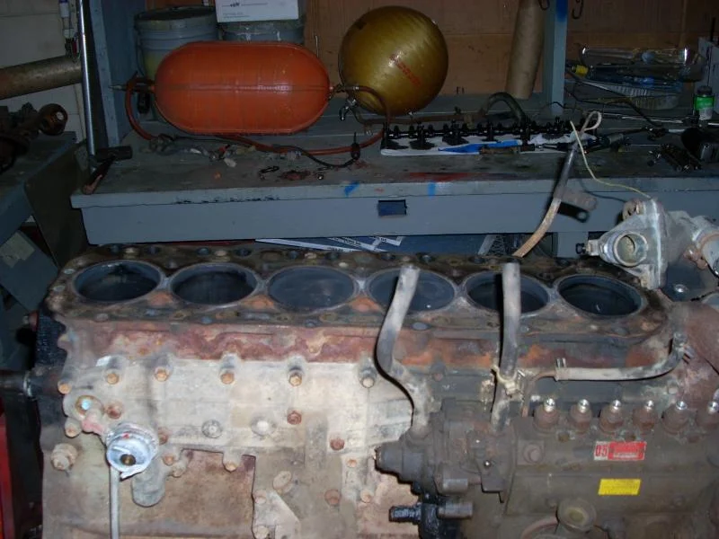

Decided to do a top-end rebuild of the 2H as a preventative measure. Head is at machine shop...
