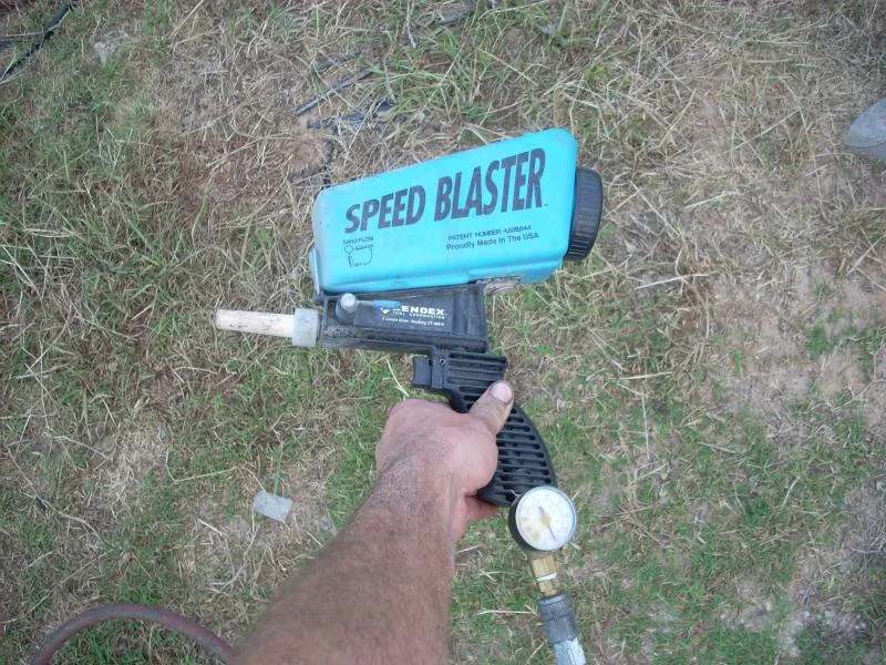

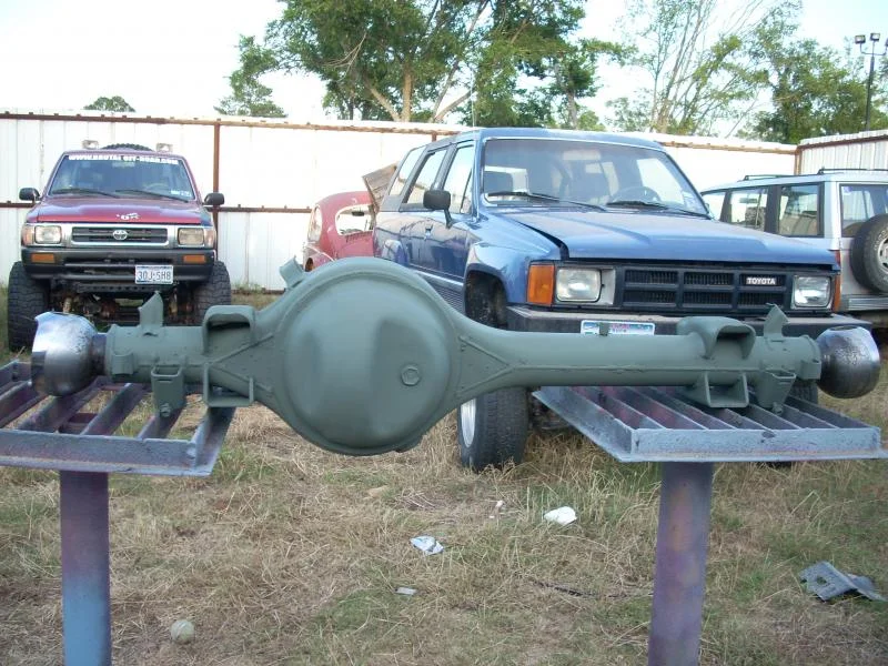

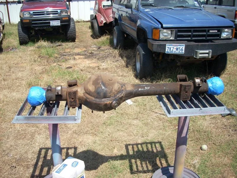

Finished with the prep work for the axle rebuild today. I hot tanked everything that would fit and then sand blasted the housing and painted it. Now, all the parts are clean and primed. I'm gana throw a coat of flat black on everything and then I should be ready to reassemble once the Aussie lockers come in. I'm using the FJ housing and the third from the HJ (fine spline 4.11)

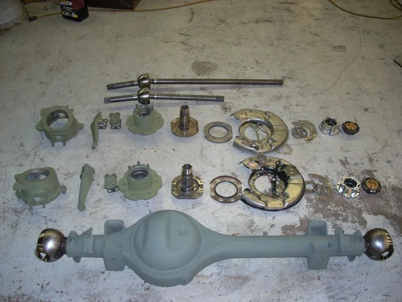

One last pic for the night: All the axle parts lined up and ready to go: More to come this week. Rhino lining of the interior should be done in the next couple days

That speed blaster is something else, isn't it? I only wish it held more media.
Looking great! Keep up the good work.

How long did it take you to blast that axle with the speed blaster? That is one clean axle.

About 30 minutes. I used a scrapper to get the inch thick grease/mud cake off and then hit it with the blaster. The local contractor supply store sells 100# bags of the sand for $6 and the axle took somewhere in the neightborhood of 20-30# of sand.

The hopper size is definitely the biggest draw back...
I keep thinking it should have a "ghost-busters" style backpack full of media and then use venturi to bring it into the gun.
I need to patent that idea.

Yeah man, or at least a hopper to load it quicker. I hate loading that damn thing with a cup.

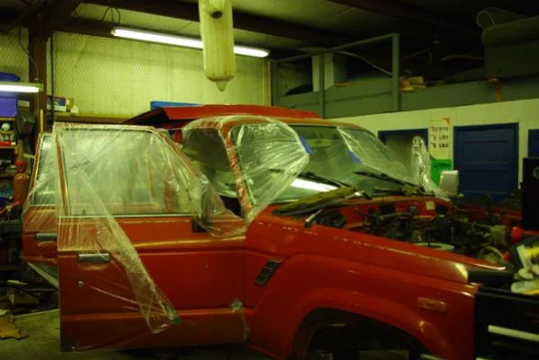

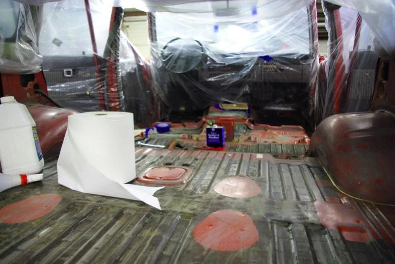

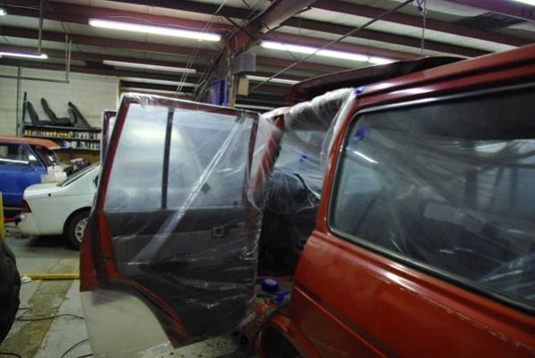

We prepared the surface for Rhino Lining by first scrapping up ALL the insulation (using a heat gun is really helpful here) and then sanding the surface. The following pictures are of the prepared surface and everything plastic wrapped waiting for the spray. More to come...

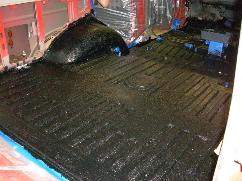

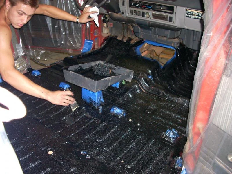

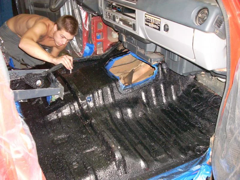

Here are pics from tonight's kinda "rhino-lining". The spray crap didn't work / Travis couldn't find the activator so we wound up using a roll on type that we added extra rubber scraps too. I think its gana come out pretty well all things considered. At the end of the day, this lining doesn't have to put up to weather, just feet, so I think were gana be okay here =)
By the way, I'd like to give a quick "shout-out" to the two other Toyota guys who are helping me head up this project; most of the guys in the shop have been / are helping, but these two guys are doing much of the leg work with fundraising and planning along side me. They have been a huge help
Travis Roberts (scene in pics below) He is on the board as: traviszesty201 (click here to see profile)
AND
Leni Moore who is known as:
toymaniac (click here to see profile)
