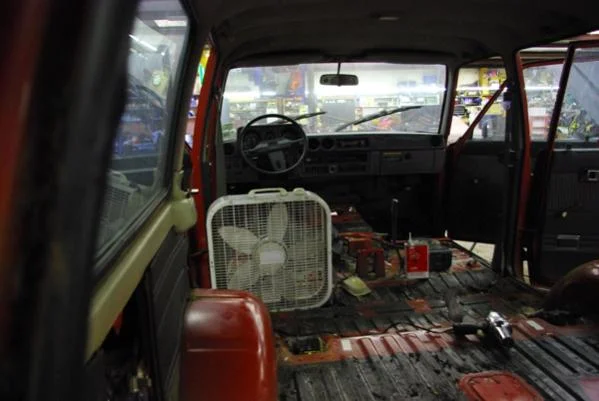

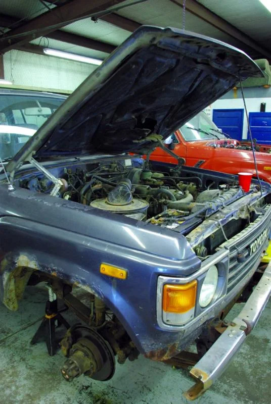

Three more. Next weekend we will do the same thing to the HJ. We have decided on running the vehicle on 12V for many reasons; these include but are not limited to:
1. Able to run true dual batteries and not have to have a total of four batteries.
2. The HJ has no A/C controls (this is the major reason) so we would have to track down everything.
3. Most vehicles over there are on 12V systems
More Pics:

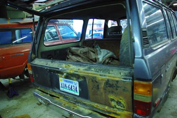

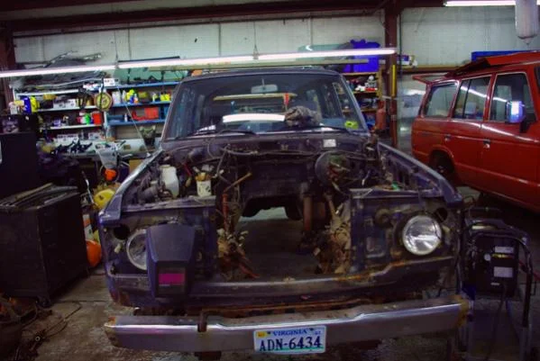

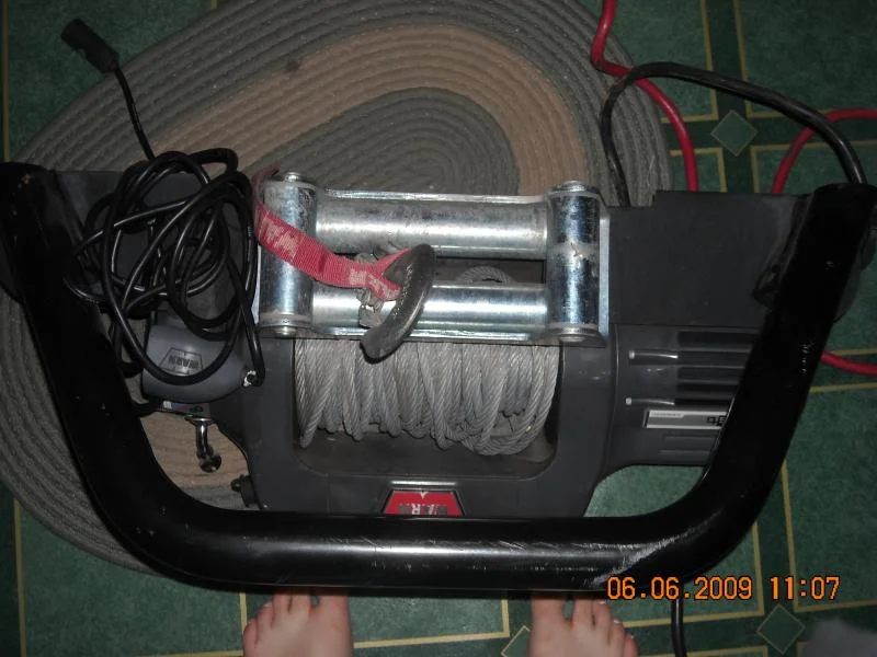

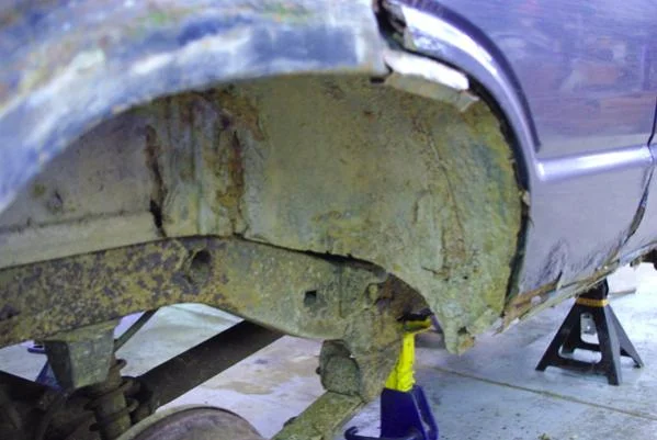

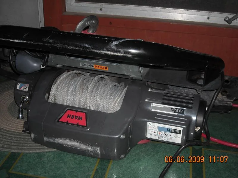

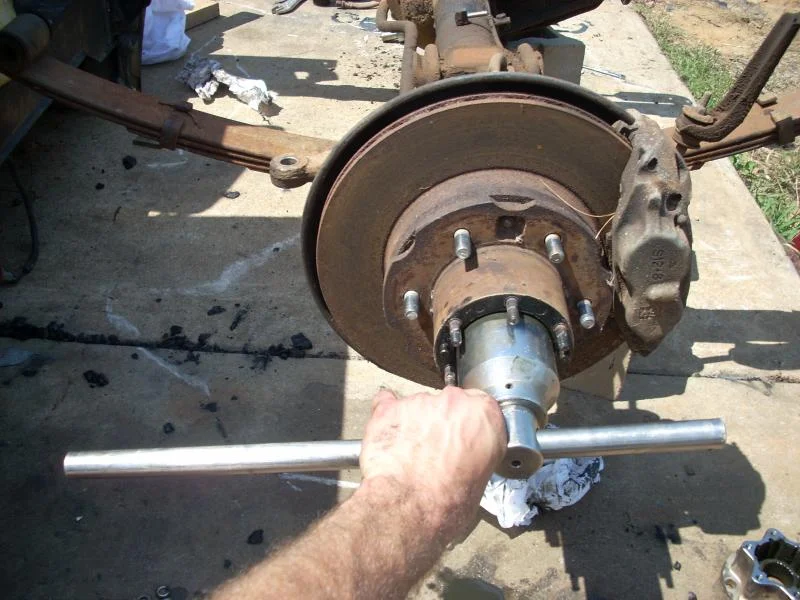

This last weekend we pulled the drive train form the HJ and learned just HOW BAD the rust is.

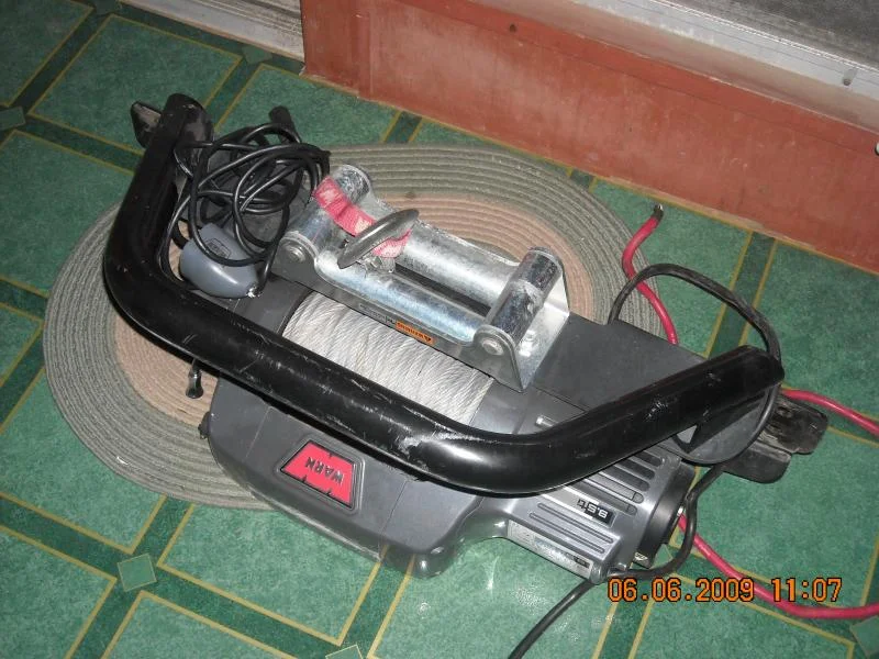

We had someone give us a 6 month old WARN 9500 that has only been used once so thats really cool.

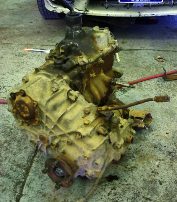

More pics

Wow, that body is pretty rotten. How's the frame look?

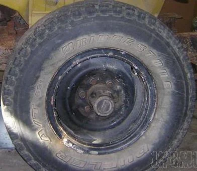

was just looking 5 picture up from the bottom mate that shockie you can see with the spring around it are these custom or off the shelf what are they better for

Those are the cheap-o overload shocks. Its a quick fix for:
A) A rig with sagging rear springs
B) Someone who consistently overloads the rear of their rig.
I don't recommend them and think they are very red-neck.
I believe helper air-bags are they way to go for said problems
Terrible. Its a wonder the fuel tank hasn't fallen out...

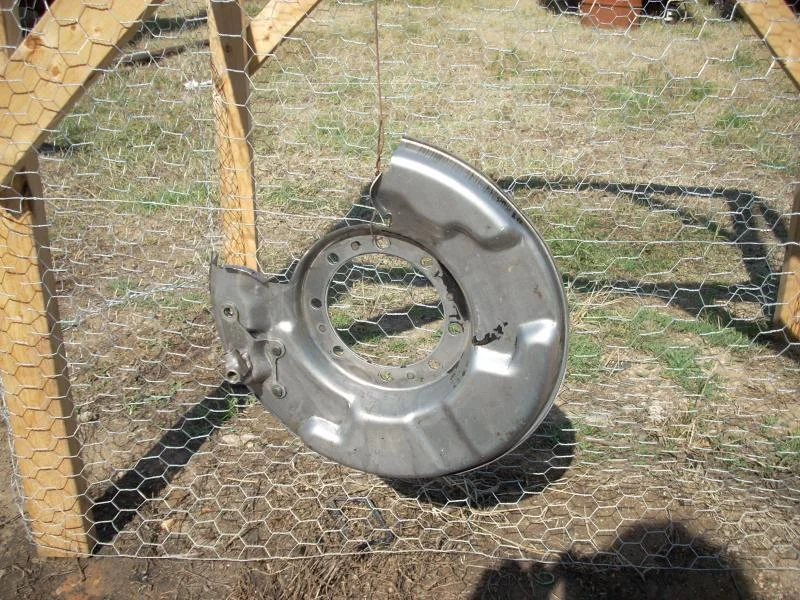

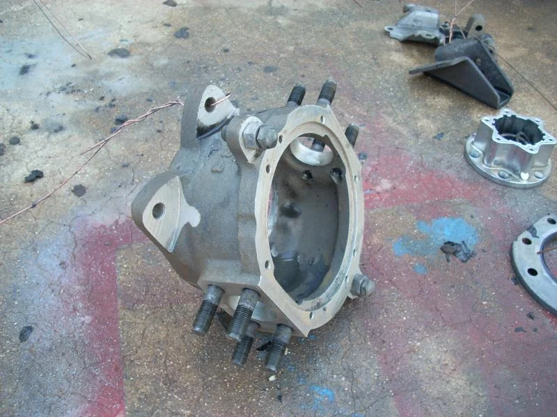

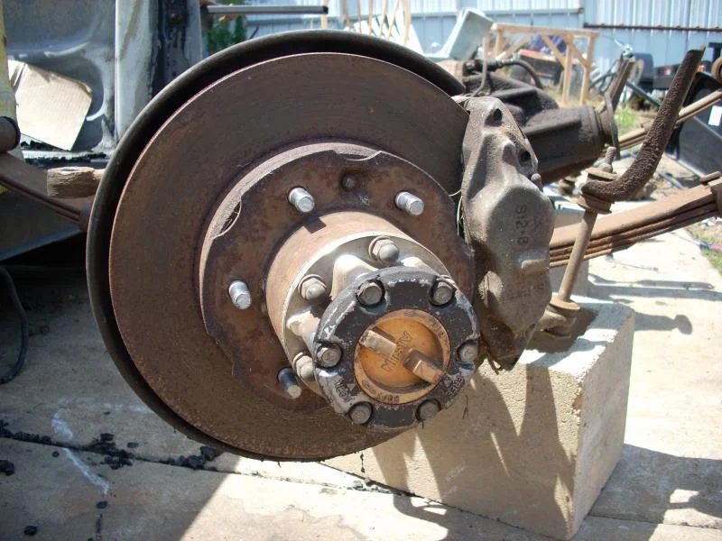

I was alone today as none of my helpers were able to come. I only worked about 4 hours and actually got a lot done in four hours. I broke down the front axle of the FJ, dropped everything steel in the hot tank, let it cook, and then gave everything a coat of self etching primier to protect it from the E. TX humidity.
Here are some pics from the days work:

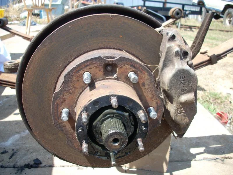

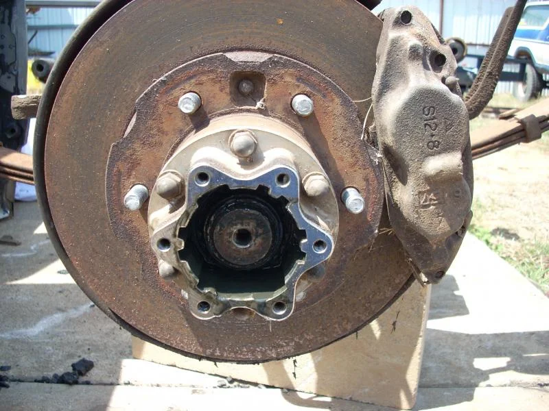

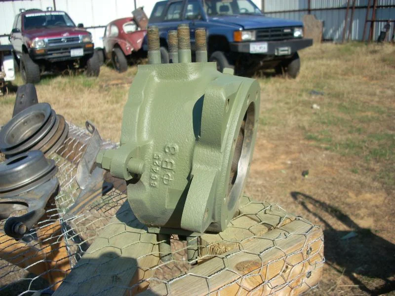

Notice the difference in the before and after the hot tank; it works miracles in minutes!
Question regarding dust covers: My thought is that they will be totally useless as they will just pack out with mud. I am thinking of modifying them to hold the brake line and thats it. Anyone have experience with this?

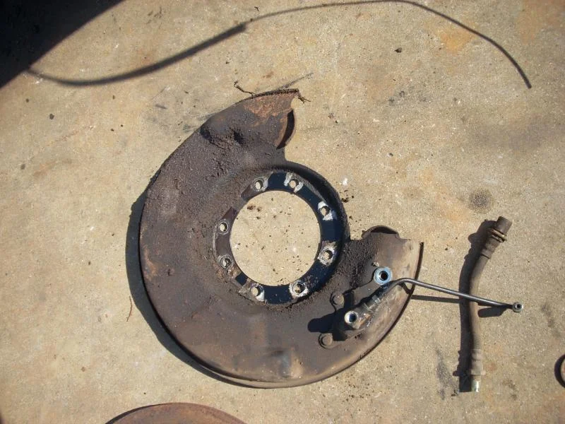

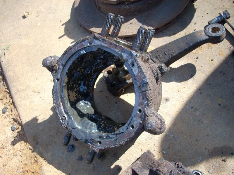

Again: Before and after on the knuckles... I was very impressed. Looked like a new casting...
I am probably gana make a big order to Marlin this week for all the front axle re-build parts. Unfortunately, they were unwilling to donate anything, but I still want to support the company so I will continue to purchase from them...
These are tough times for all companies =(

Donations update
One more thing:
Just wanted to let everyone know that we have had steady progress with donations. We have probably had an additional $1500 since I started the build thread.
One guy here in town says he'll buy us a set of tires which is a big help
And we had a 6 month old WARN 9500# winch donated that has only been used twice. Any kind of donations of this type are awesome! Thanks guys!
We are really looking for 8 (2 sets) of 16" split rims right now. A few guys on the board have them, but want an arm and a leg for them; if you have some and want to donate to a good cause, PM me
Here are some pics of the winch thats coming from Yankee Land...

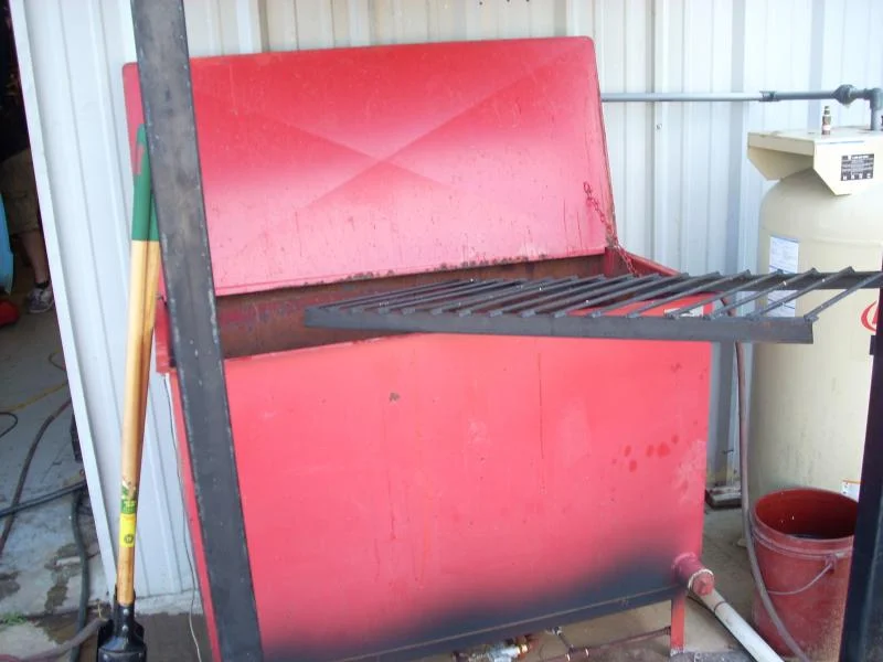

So true. Zuluzeugma, approximately how large of a scale is your hot tank? Are the dimensions small enough to warrant it's place in a small garage?
Split rims... er... sorry do you mean the old FJ40 rims with the tabs?
Heres a pic; It could easily take an F series Engine block. It was donated to our shop about 3 years ago and I got it hooked up and running about a month ago. I just plumbed it into the shop's natural gas supply and then ran an air line to it to keep it bubbling. I usually run it about 180* F.

I think were saying the same thing... They are much easier to swap in the bush as almost everyone runs tubes so if then get a flat they can bust the wheel apart, fix the tube and be back on their way...
