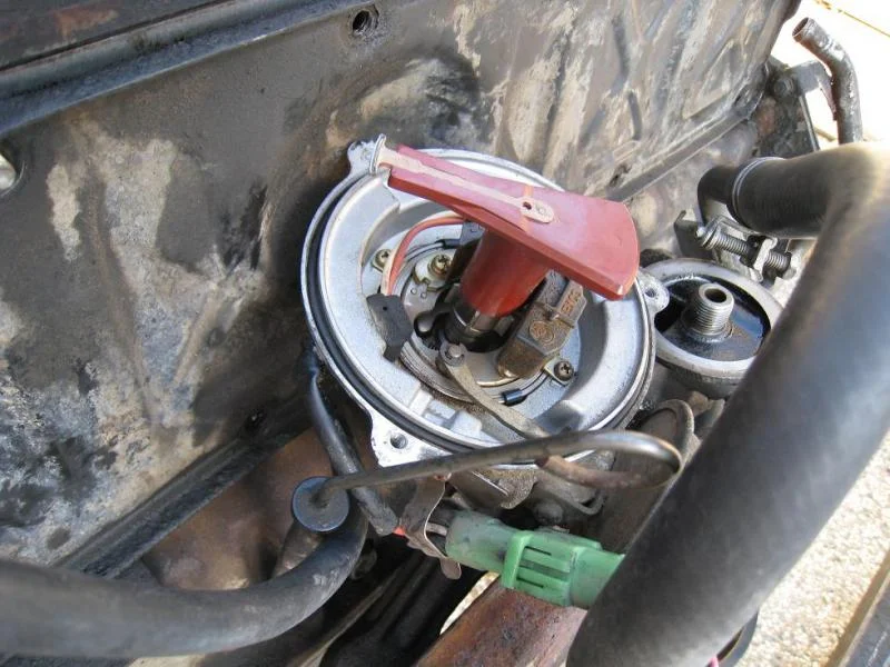

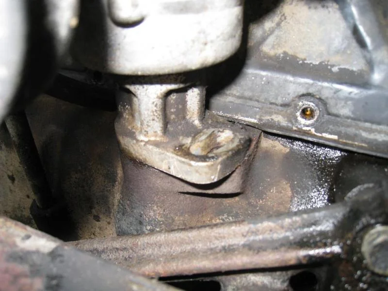

Can anyone help me how to remove a distributor I lose a screw but I can get it out .

Quote:
Originally Posted by Mace View Post
Pull hard..
After you've oriented the rotor towards plug #1.

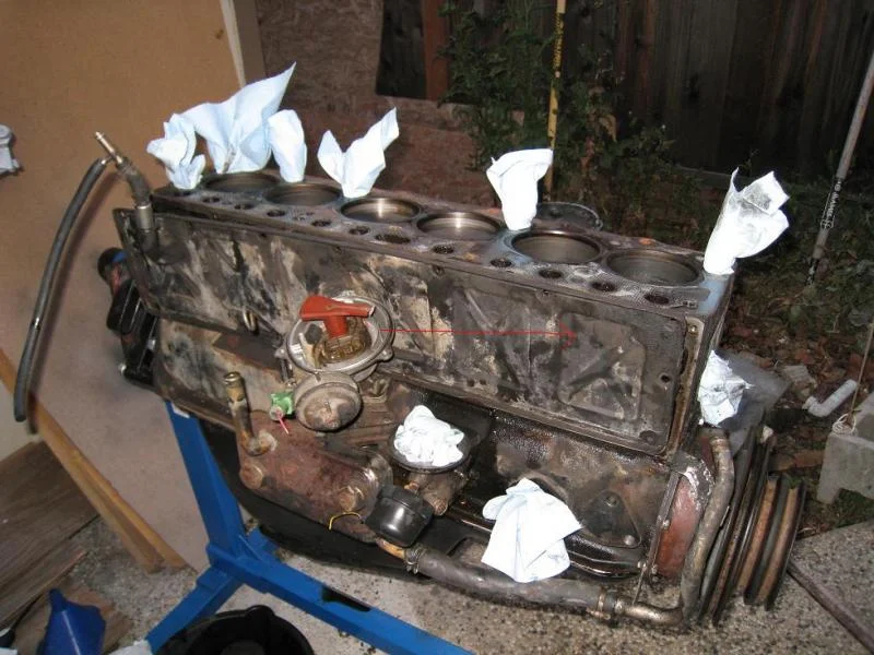

is this rotor pointed plug #1

Ah, I didn't realize the ole beast was out of the truck.
If you are tearing the motor down much further (like pulling the crank) then don't bother orienting the dizzy first. Just pull it out. There's likely a nice crusted groove of deposits that's holding it in when you try to pull.

I tapped the slot from below with a rubber mallet when mine was out of the truck. It just needed some persuasion.

I get it out Today I used the rubber mallet and tap it Thanks to Klinetime574.
