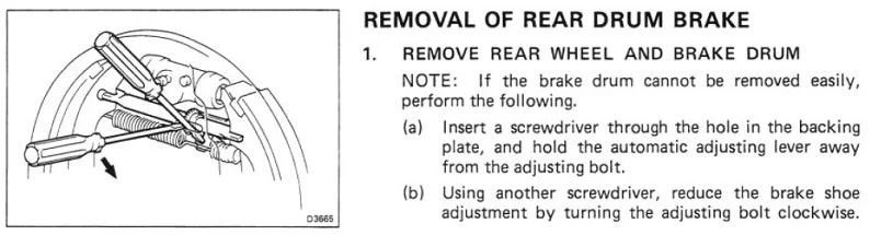

It's like Wile E. says, you need to use two screwdrivers one to lift the lever, the other to turn the adjusting wheel (or one screw driver and one brake adjusting tool). The lever, when engaged, only allows the wheel to tighten and prevents the wheel from loosening.
I can't seem to do it the way it's shown in the manual where you disengage the lever by pressing it outward from under the adjusting bolt. I've written myself a note in the margin of my manual,
"put driver in access slot towards front of vehicle. Lay the driver on top of the adjusting bolt. Push the driver outward to disengage the lever".
Good Luck.

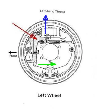

Old 04-28-09, 10:03 PM   #6 (permalink)
Forum Lifer
2mbb's Avatar
The lever is indicated by the red arrow. There is very little of the lever available below the adjusting bolt. That why I try and find it above the adjusting bolt.

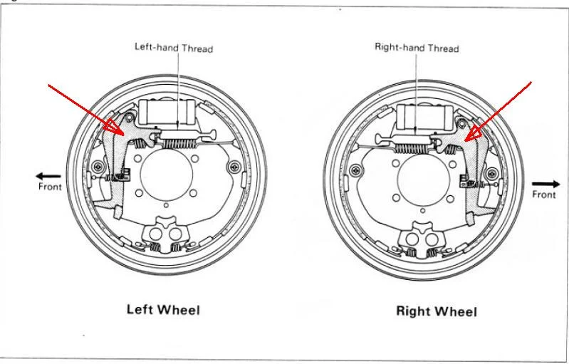

Old 04-28-09, 10:10 PM   #7 (permalink)
Site Addict
Trapper50cal's Avatar
Join Date: Mar 2005
Location: Durango, CO
TLCA# 15812
Posts: 1,801
yup, in each case you can see that "behind" the starwheel (further back on the truck) there is a little tab "above" the crossmember holding the starwheel. This area corresponds to the backmost edge of the grommeted opening.
I think...
By trapper50cal at 2009-04-28

This is exactly what I had to do! Thanks for all the helpful info. After I went and bought the curved tool and used this modified method it was a snap. The screwdriver just didn't have enough bite on the star wheel, almost rounded it off actually.
