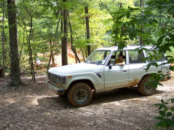

Well, after having this affliction for about 10 years, I'm finally attending my first Cruise Moab. Most of this work was done over the last month. We recently moved to Utah and I can't be in this great wheeling state without a properly outfitted cruiser. I work in the arts so I'm not exactly loaded, so I took on a part-time position as adjunct faculty teaching a university graduate seminar on contemporary art. They thought I took on the extra course because I love art, but really it's because I needed to feed the cruiser affliction. This semester paid for the lift, locker, and tuning up the cruiser. Next fall semester will come a SROR rear bumper and arb front with a winch. Here is a before pic as we were moving from DC to Utah last year. We really loaded the cruiser up (this was stuff we didn't trust with the movers) and it did great.
More images to come tonight of the OME install, locker, and tune-up.

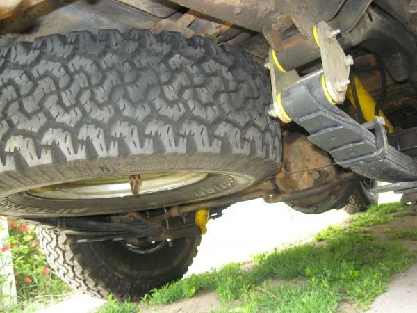

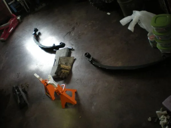

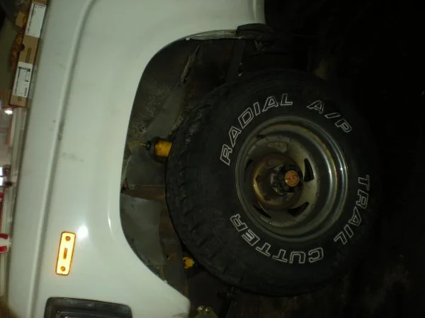

And now on to the install of the OME. This was WAY tougher than I thought. Nearly all of the difficulty came in trying to remove the old rusted suspension. I bought my first cruiser while I was an under-grad and newly married, a 1973 fj55. My wife also loved the cruisers and encouraged the habit. I spent evenings after class learning bodywork on it, then we had it painted black. It was a great cruiser and we had a lot of fun, except for the time it caught fire on our way back from Moab in 2001. I'll have to dig up some pictures. After that my wife swore off old cars for a while (think stranded in the desert for several hours, looking back she was pretty patient), so it took me a couple of years to persuade her we needed another one. We had to sell the 55 when we moved to DC because our high-rise didn't have enough parking (yep, it still ran even after catching fire...just not well. I think it's been parted out now). In about 2003 I found our current fj62 online. The family had owned it since it was one year old and taken great care of it, they even got teary-eyed when they sold it to us and made us promise to take great care of it. The drivetrain was in great shape, but it had rust. I was still a newb to the world of cars (I still am, that's what comes of working in museums) and figured it would be better to have a dependable drivetrain than a solid rig. Lance at IPOR said at the time I had the strongest running 3fe he had heard, but he just smiled and cringed when I asked him about the rust. I thought I could fix the rust and have a good cruiser. Well, after many attempts the rust is still there and now worse due to salted roads in Utah, but that's another story. The wifey insisted on auto transmission and power steering, while I insisted on classic cruiser styling. So the 62 was the perfect compromise for us. It was a NYC cruiser so we bought one-way tickets to the big apple and drove the cruiser home to DC. This wasn't too long after 9/11, so the toughest part of the trip was convincing the airline security we weren't terrorists and if we were we would probably be smart enough now not to buy one-way tickets from DC to NY. We joined the Capital Land Cruiser Club (CLCC), a great group of cruiser heads, but always longed for the mountains in the west. After finally moving out here last year we made the commitment to outfit the cruiser and use it as our family get away wagon.
Anyway, after that long-winded intro, on to the OME install. First are the new springs. The great thing about being in Utah are all the offroad fans and cruiserheads, it's like being in 4x4 nirvana. After being back east for 7 years it was a rare thing to see a lifted rig, let alone a cruiser. I've got 3 herniated discs in my back so my friends Ty, Christian, and Devon really came through to help me install the lift (I say help but I was just moral support, they did all the work ). Christian has a shop and is a big cruiserhead, he's currently got a 40 and a huge 80, and probably another dozen cruisers between his brothers and cousins.

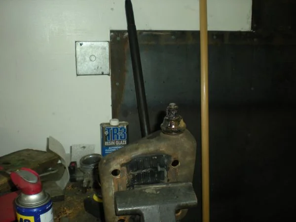

I soaked everything in PB blaster for two weeks straight before the install, so the bolts came off pretty well (all but one...). But the bushings were toast. After pounding and chiseling to no avail Christian broke out the torch and burned the old stuff out.

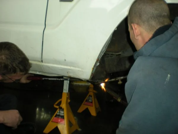

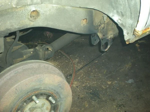

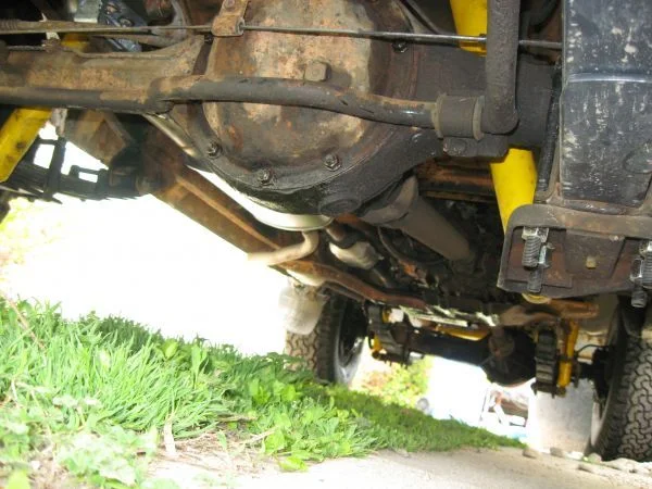

When removing the rear shocks we broke a bolt. We tried welding another bolt on and unscrewing it but it didn't want to budge, so we just welded a new bolt to the remaining portion, threaded it, and called it good.

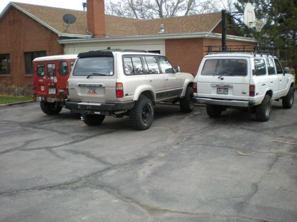

I never could have put this one without my friends, it was a big job. Between the 4 of us (okay, really 3.2, I didn't count for much) it took about 6 hours total. Not too bad considering. And now onto the poser shots. I wish I would have taken more, I had a meeting I had to run to and not enough space to get a good full-side shot, but you've seen enough OME before and afters to get the idea. Here she is newly lifted on the old 31s.
The last shot is next to Christian's cruisers. He's got a well-used 40 and a monster 80 on 35s.

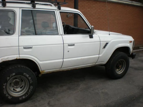

The 62 looks awesome!!! I gotta tell you though, that's not bad rust yet. It gets much worse, let me tell you. If that was winter 1 then expect your body to disintegrate after winter two, like mine has

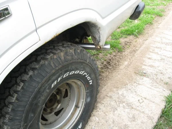

Next came the locker install. I wish I would have taken more pics. It wasn't too bad, we put in a lock-right and the worst part was the second c-clip. We used black permatex for the gasket and put in a heavy weight oil. The first few times I drove it it clicked, but I haven't heard it since! I do get the occassional tire chirp, but nothing too bad. We'll see how it does in the snow. You can also see the new muffler in this shot, it's tucked up nice and tight. The previous muffler was more swiss cheese than muffle. It also now exits behind the driver's rear tire instead of the back, hopefully I won't squish it coming off of the fins in Moab. And yes, that's a bad bondo job in the wheel well, I had an enterprising guy follow me home one day and offer to do body work in our parking lot. He had all of the tools in his trunk and said he would replace the rust with metal. I left him for a little bit to work on it (bad mistake), came back and he was actually using tinfoil (no I'm not making that up) as his "metal replacement" under the bondo. I was pretty mad but it was already on there. Another project for later this summer.
I bought the locker from Kurt at Cruiser Outfitters. He just lives about half an hour from me so I was able to stop by his house and pick it up. He's a really cool guy and his customer service was just as great as numerous others have stated. His garage is packed with OME parts and other goodies, not to mention the amazing rigs and trailer he has.
Also notice the new tires, 33x10.50 BFG all terrains. I wanted to get muds but realistically this will spend most of its life on the road so I needed a decent street tire too. I've got to get some profile shots of the now-lifted cruiser on its new rubber.
Thanks, it's definitely coming along. She's originally from your neck of the woods, so you know about rust. Sadly it's worse than it looks, the rear frame around the spare is more rust than metal. It peels apart like baklava!

Quote:
I hear you! Rust is the enemy and most of the cruisers from the northeast need a new frame at some point. A year ago, I ripped the DS rear spring hanger right off the frame due to rot, so I feel your pain.
Still, awesome truck!

I need to take a pic but I also lifted the LSPV by 2.5 inches by using a metal light switch box ala RockDoc. The brakes were really mushy after the lift and took longer to stop. After lifting the LSPV they're better but still not great, maybe it's the larger tires?

Did you adjust the little star nuts in the back?

You know I don't believe we did, we just lifted it the 2.5 inches.

Put the rear up on jackstands, block the front tires, put it in nuetral and click those star/wheel nuts (they only click one way w/o depressing the lock arm) to tighten...but do it slowly (small intervals) and spin the rear tire to listen if the shoes are making contact with the drum surface. They prob. are out of round a bit so you will hear just a tiny scrape. If you go further than that you will have to back them off a bit. Try to do the same amount of resistence on both sides. That may fix you up.

And here is the poser shot of the whole enchillada post-lift and 33" tires. Cruiser is parked in front of my museum. The second images is the view from the museum looking out (you can see the cruiser on the left behind the tree 5 cars back). This is why we moved here, you can't beat the views. We live 5 minutes away at the base of the mountain. That's a Reuben Nakian sculpture in the foreground, and Squaw Peak in the background.

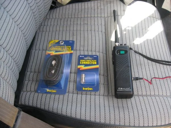

The latest "upgrade" is the cb. I can't believe how hard it was to find one, I couldn't find anyone local who sold them. There are several radio and communication shops that carry Ham, but they said cb was outdated and recommended two-way radios. Radioshack didn't have any in stock either. I thought it was pretty funny, but the one "establishment" around here that carries cb's is Flying J, as in the gas station. My wife refused to get an in-dash unit and absolutely would not yield, images of Burt Reynolds and organgutans flying through her mind's eye. So we went with the handheld unit. I know it won't work as well but hopefully it will be okay out on the trail. We also got a magnetic antenna to extend the range. The connectors are different and the J didn't have any adaptors in stock. Is there any reason this combo wouldn't work? The coaxial cable has one end that will fit the antenna and a smaller one for the handheld, with a double female connector in the middle.
