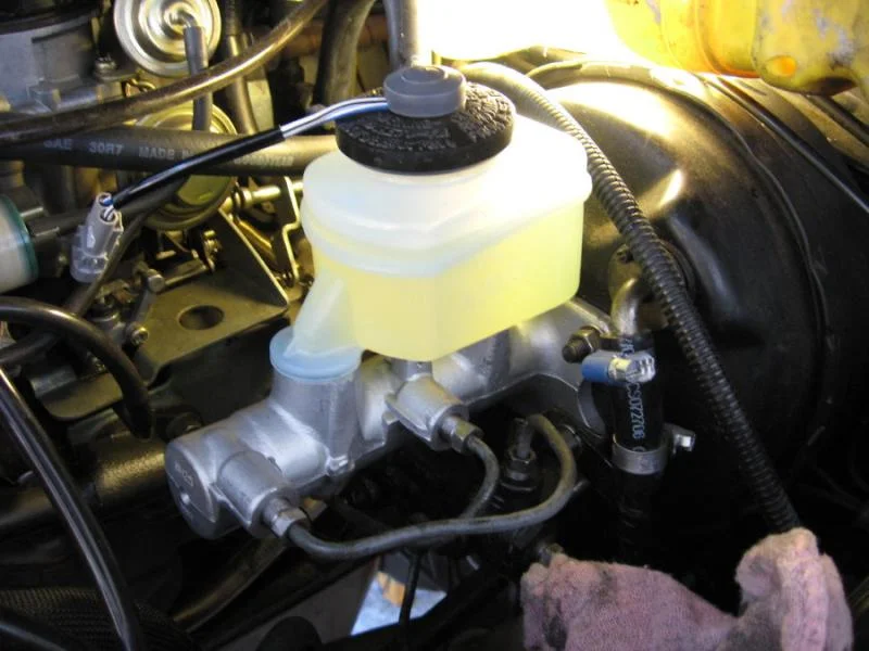

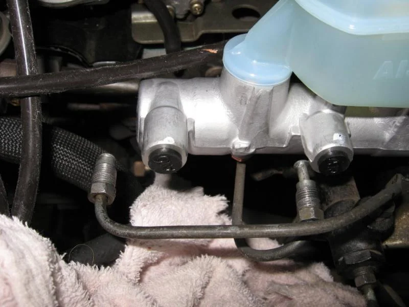

Yes, used a 20mm hone (the kind with the abrasive balls) ... but that's a good point about fluid moving from chamber to chamber, didn't realize that.
But it's moot, now. I broke down and went out and bought a new Aisin T100 MC according to this write-up: Toyota Land Cruiser Brake Master Replacement and Upgrade- ORN
I've run out of other things to try.
For anyone else looking for what MC to buy, I got Toyota part # 47201-3D020 which also corresponds to 1986 + V6 truck. I got the one for the T100 because you can splice in the level sensor to work with the FJ60.

Just curious, in the pirate4x4 article, the new MC is Cast Iron. The new Aisin I got (same one) is aluminum or some Al alloy. All the others Aisin MC's I saw on-line look like Aluminum too. Is this cheaper production?

AL is better... it does not corrode and pit from moisture absorbed into the fluid the way the way the older iron ones do.
Toyota switched to Al with the 80 series and with the T100, Tundra and Taco and all newer rigs

Quote:
Where did you get the MC?
So you did or didn't get 47201-3D020?
I have been waiting on the Marlin MC to come back in stock for over 3 weeks to make my switch.

Yes, that's the one I got.
I did a lot of research on the diff MC's available. The one Marlin, Downey, All-pro, etc., lists is an early FJ80 1" bore. But their focus is not LC's --

Haven't finished bleeding it yet (have to wait for the Mrs. to finish cleaning the kitchen before she'll help me... ) So no evaluation, yet.
Here's the MC installed.

You'll have to bend the lines, slightly, to get them to fit... I loosened the fittings at the Proportioning Valve to make it easier.
Before bending.

I'm getting some weeping past the threads on the fitting under the reservoir -- Have to take it apart to see how I buggered the flare.

Is that what you have been calling an LSPV?
I was not paying attention before.... your 60 does not hve a Load Sensing Proportioning Valve.
That was introduced with the '62.
the LSPV is under the back of the rig.
The valve mounted to the brake booster is just a plain old proportioning valve to balance the disc up front with the drums in back.

Yes, that's the one.
I went to the store, 'cuz they're near me... You might be able to find it local.
And I have to say, the larger MC may not be needed but, at least for me, it made a world of difference in pedal feel... Rock solid now. With the stock, pedal travel was excessive, for my tastes.
