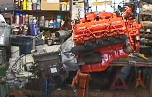

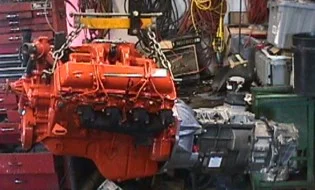

Got my drive train bolted together and ready to drop in.
Pretty damn heavy. This setup sure tests the limits of my engine hoist.
I'll probably have to get stronger front leaf springs. for sure.
Got a lead on a Banks turbo setup for cheap. I'll have to do some measuring to see if it will fit.

Good for you! I am interseted in your results; the 6.2 is the way I'd really like to go in my 60 at some point too when my 2f expires or when cash and my experience gets further along. (I envy the fact thst you have all that stuff there to do that too!).

Any clue how much that thing weighs?

Id venture to say about the same as a big block chevy.

SS Storm, Good to see your post that you're happy with the Banks.. I was kind of skeptical about putting the Banks kit on at first because I read some threads on one of the diesel bulletin boards about heads cracking between the valves after they put the turbo on. But I searched more and seems to be many satisfied people that haven't had any problems.
I just called the guy that is selling the Banks. He says he bought the Banks kit only a year ago, wants $700 for it and the running 87 Chevy shortbed truck it's in also. Can't pass the deal up, so i guess I'll go for it. Nothing wrong with having a spare engine too.
I 'm gussing this engine, tranny & transfer case weighs about 1,100 lbs. Just a guess.
