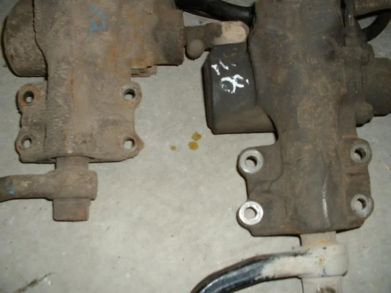

are the first year 60's differnt? 8-80 thru 81?
here are pics of '82 box and an '87 side by side

8/80 through 8/81 is listed as a different part, but what is different, i don't know. haven't found a pic yet.
the pic above illustrates my conundrum perfectly. i can get the offset bolt pattern all day, but i need the square bolt pattern.

it'll only be the same if it's 4/85 or earlier to 8/81. different bolt pattern where it mounts to the frame.

You are right. I grenaded one years ago and found out about the different bolt pattern on late '85s.
