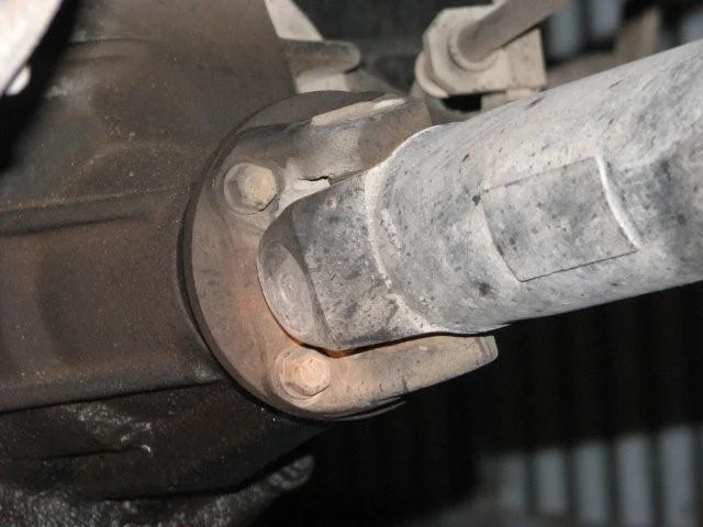

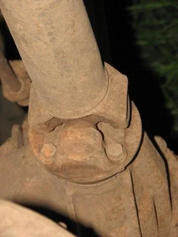

Im looking at replacing the 3.7's in my HJ60 with 4.11's from a 1986 HJ61. The HJ60 is a Jap 24V imported to Oz, with 33.5x12.5x15's.
Dont know if the FJ's are the same as the HJ's, but on mine the bolt patterns look the same. I measured 65mm x 65mm on both flanges. HJ61 on left, and HJ60 on right (with leak)...
