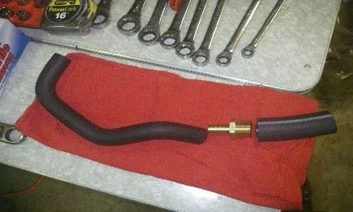

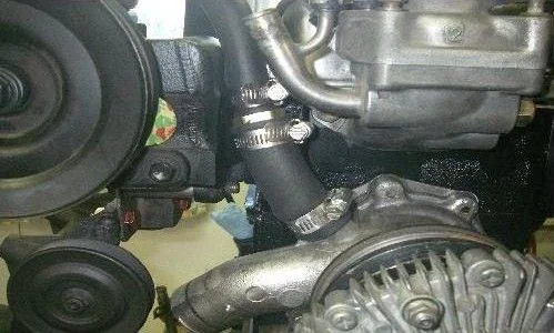

you'll have to use the 2f waterpump. The 3fe wont mount up. Hose sizes are different so you've gotta rig up a reducer.
Here's mine
Home Depot fitting
I'm still trying to get mine started. Starts right up but she refuses to run right. Very frustrating.
