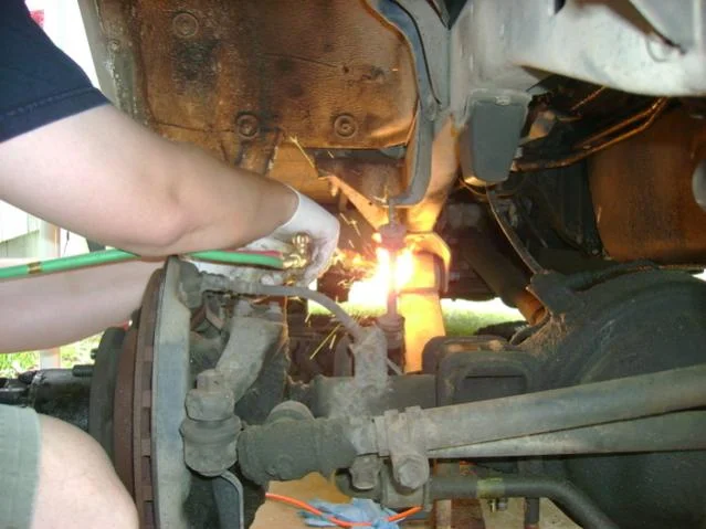

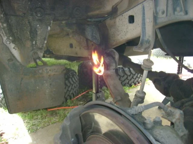

J-Bo...go ahead and start to spray your old springs, pins, and shackles down with some PB buster to help loosen everything up.

Good tip! I've been doing that every other day for about a week. Hopefully it'll help. I'm doing this at my Dad's house...he has more tools than I do.

I remember when I put on my OME lift and took the first drive. A propane torch helps to heat up the pins when removing them from the stock bushing.

lift
Josh
Your going to love the ride compared to stock. The ultra heavies are a bit bouncey at times, but 100% better than stock. The first old spring we took off came off super easy, and then the other three we had to cut off. Luckily for me, we did my lift at a HAMOM, so there was some experienced people helping install. Good luck and let us know how it turns out

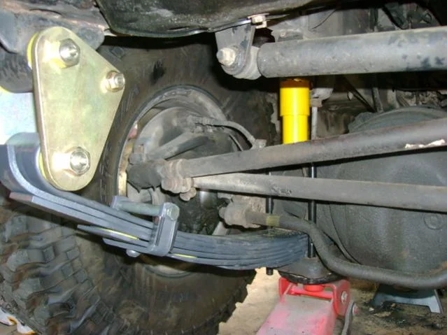

Parts list:
Front--
Shocks--OMEN50 x 2
Springs--CS005F (OME111) x 2
U-Bolts--OMEU51 x 4
Shackles--OMEGS2 x 1
Rear--
Shocks--OMEN90 x 2
Springs--CS005RA (1131A) x 1 & CS005RB (1131B) x 1
U-Bolts--OMEU59B x 4
Shackles--OMEGS1 x 1
Bushings--OMESB1 x 4
Anti-inversion Kit--FK08 x 1
Greasable Pin & Plate--OMEGP1 x 2
Steering Damper--OMESD24 x 1
These are the only pics I got before dark:
And a couple of pics of the 62:
The fun begins in the morning!

Ok, here's yesterday's story. So I got started around 830/9 and everything seemed to go like clockwork until I had to remove the hanger pin. Heat, hammer, heat, hammer...finally it came out. Lesson learned--when the guys on MUD suggest using a torch...TORCH IT! Don't heat it up a little, heat it up 'til the old bushings start to spit little rubber fireballs at you. If you do that, then take your BFH and brass drift to it, it should come right out with a couple of swings. Install of new stuff went in pretty good. Needed a little but not much. About an hour and a half and the passenger side front is done. I figure that's no too shabby for a newb.
On to the driver's side front. Pretty much the same story until we got the the hanger pin. This time, as it turned out, the pin, bushing and spring were fused together. I think it's because my exaust runs so closely to the hanger that the heat must really do a job on those parts. Torched it. Nothing. Didn't even budge. After about an hour just on this part alone, it finally moved enough to cut it off. This time the install of new stuff took a little longer, but still to be expected.

Before:
My dad and Cirbo under the front end lending a hand with my son supervising:
I have a couple more "during" pics but I have to get them off my phone.
After:
A BIG thanks go out to my dad and Cirbo. Thanks also to eventhough for listening to my mouth on the phone yesterday afternoon. I'm glad to have it done.
Let's go !!
