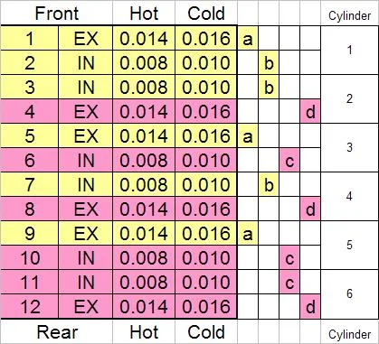

Last time I adjusted my valves, I did the cold according to the excerpt in this post: IH8MUD Forums - View Single Post - 2F/3F hot/cold valve set. I added 0.002" to the valve clearance. All the clearances measured OK--I did not have to adjust any of the valves. It had been 20K miles since I last adjusted the valves hot.
Here's a table I use to help me adjust the valves. I set the engine to TDC on the #1 compression stroke, then I check/adjust the exhaust valves indicated with an "a"; counting from the front, valves 1, 5 & 9. Then I check/adjust the intake valves indicated with a "b". Then I rotate the crank 360 degrees back to TDC on the #1 exhaust stroke. Then I do the "c's", then the "d's". Doing the intakes and exhausts in sets of threes helps it go faster, which is good if you're trying to do it hot.
I also find that a "step" or go/no go feeler gauge is handy. This is a feeler gauge where a distance back from the tip the gauge step up .002". If the tip goes in but the step-up doesn't then the valve is adjusted properly.

2mbb's chart should be added to the FAQ. I adjusted my valves for the first time ever today, and his post made it easy. FWIW, I checked w/ the engine cold, and most of the clearances were right on the .002" over mark. A few were a bit too tight, so I set them to the cold specs too.
