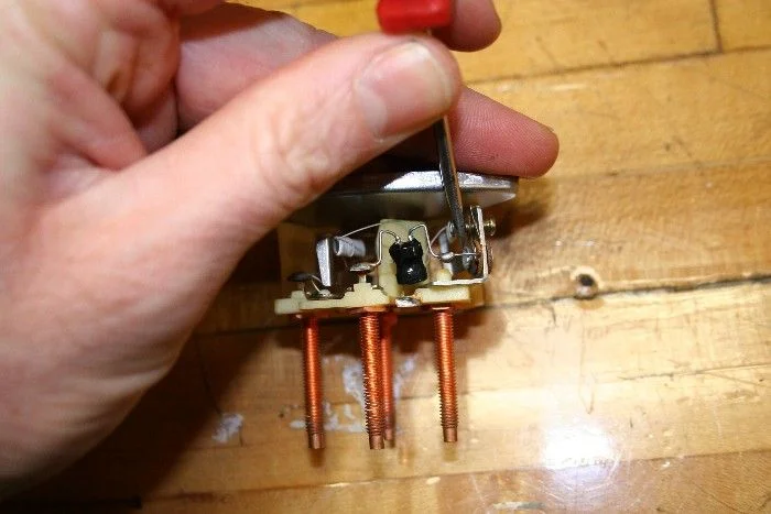

someone showed me
yes take the cluster/dash out(its super easy) and then the fuel guage out. On the back of the fuel guage you will see a little points contact, clean it with some emory cloth(or something like that) To be honest I got mine so it happened less often(it will get worse and worse) but decided I didnt want to have to worry about it for anohter 100K+ so I bought a new guage.
this is the old one, just happen to come across it today.
screw driver is pointing at the contact(that they both share)
close up

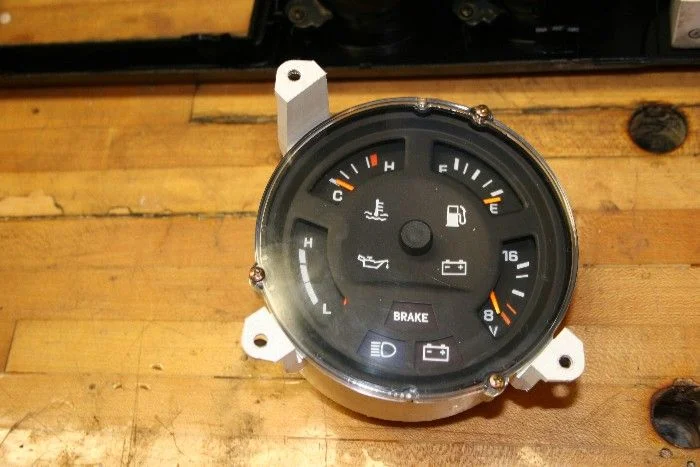

Remove the three screws holding the cluster to the dash faceplate.

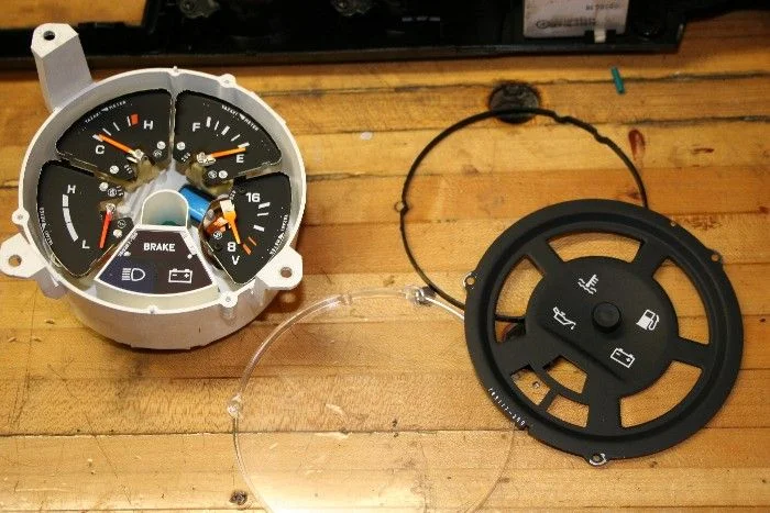

Remove the three gold screws that hold the clear plastic cover and the spacer on.
Separate the plastic cover, spacer and the metal gauge cluster faceplate.

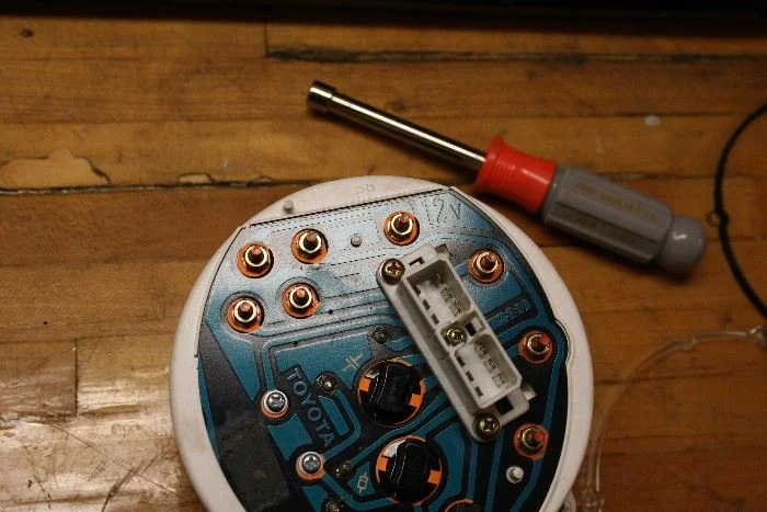

Using a 7mm nut driver remove the 4 nuts and washers. Name:  Gauges 009.jpg

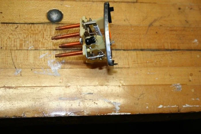

Pics of it dissembled.

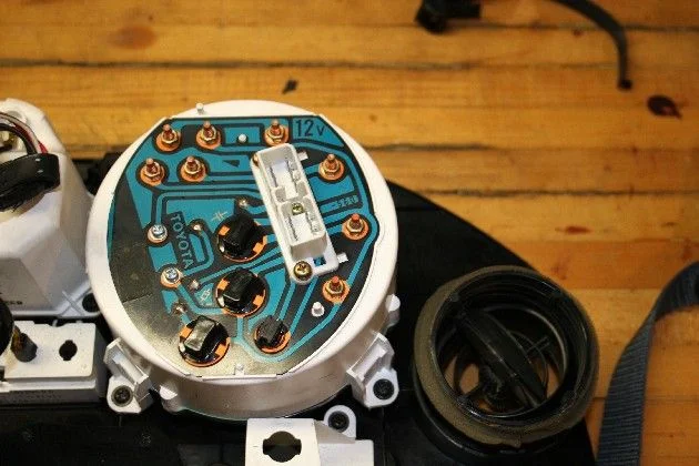

I believe this is where you clean with an emery cloth.?
