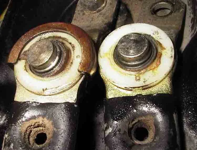

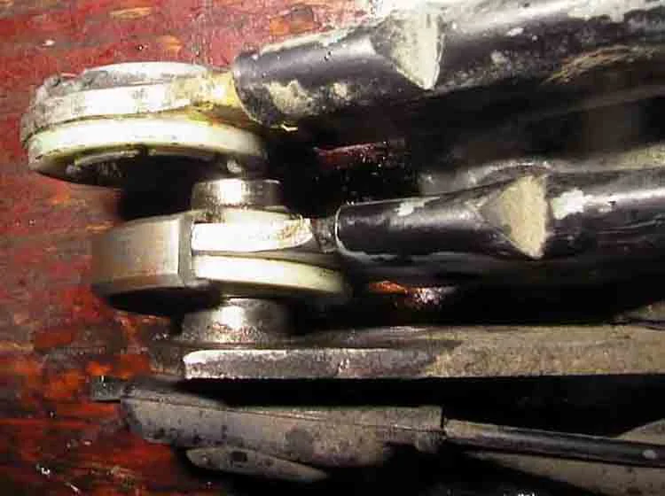

Some more info on the wiper linkage bearing fix…. Not many comments on which size bearing fix you guys need, so I’ll assume your waiting for a price on the bearings. I still haven’t gotten it yet but I have found another supplier who has the right size in their catalog. We’ll see if they have any in stock.
I did find another drawing of a part I made and totally forgot about. These are in my current 60 and have been for three years. It is another way to fix the broken plastic bearing in the motor relay rod. I reused the plastic part that snaps onto the brass ball from the original assembly. What breaks off is the plastic washer-like flange on the other side of the metal rod end. My fix is a metal clip to hold the usable part of the plastic bearing in place without the broken washer.
In the first pic, the bottom one is repaired, the top one is an unbroken original end.
The second pic is a front view. Left repaired, right is unbroken.
These I can make easily. Maybe you can too but maybe not. How’s $15 a pair sound, shipping included. You’ll have them by Christmas, maybe sooner.

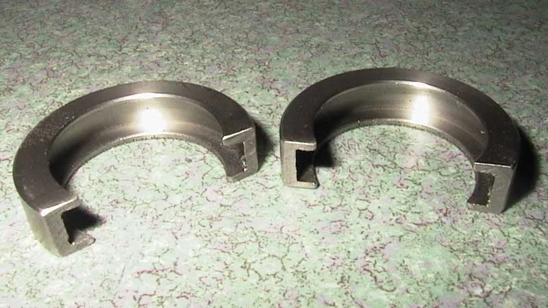

I made some of the OE plastic bearing repair clips over the weekend. They're made of 303 stainless steel so they won't rust. They snap onto the wiper linkage rod connecting the motor crank to the wiper pivots. $15/pair delivered. 100% refundable if you don't like them, just end them back. PM with questions.
Bruce

I got a set of those repair clips from 60wag. Worked well for me.
It sure beats spending $200 at the dealer for the whole assembly.

I just finished installing the stainless clips I got from Bruce / 60wag -- My wipers work like new! Great fix, ingenious. Both of my plastic bearings were blown out and the whole assembly was rattling around. Tight as can be now. Thanks Bruce.

Just did this myself. All of a 10 min job.
Great fix, the wipers are clean and crisp and no longer periodicaly fall off.
Just a note to any one thinking about doing this;
you do not need to remove the entire linkage assembly, all parts can be esily accessed by removing the wiper motor (four bolts) and one inspection plate (two screws)
One on the best $15 fixes on my truck.

Just got done putting on 60wag/Bruce's wiper clips and man they work great. Solved my problems with the wipers. Best $15 bucks spent yet on this cruiser of mine.
Thanks for sending them before my payment even cleared. This guy just saved me a good chunk of change and wanted to let you guys know his fix works.
Only needed to use one of them on mine. The other bearing still looked brand new under the rubber protective coating. So I still got one on stand by for when ever that other plastic crap one gives out.
Thanks Bruce!!!!!!!!!!! You the man

booger, send him a private message using the bullitien board.
click on his name up above and a screen should apear asking like 4 different things. Choose to send a privat message and go from there.
Its not hard, I took my windshield wiper motor and arm completely out to inspect them. Takes about 30 min. It makes it easier if you take the hood spring thing loose from the hood on the passenger side and let it lay in the engine compartment so you can fish the wiper arms out easier. There are two inspection plates on the fire wall with screw you take off so you can get your hands up in there when putting it back together.
Then just do what his instructions say to do. Its alot easier than you think it would be.
