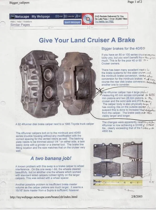

Here was a good article on this but the site appears now to be nonfunctional. Anyone know the author? Here's a crappy scan but it's all I got. It basically said to use '92 V6 4Runner calipers as they are the biggest pistons but you may need to update your mastercylinder to a larger bore to push enough fluid, your wheeel may hit the larger calipers and you have to trim the backing plates.
Name:  Give Your LC a Brake-1.jpg
EDIT: after re-reading the above link it appears to be the same thing. The scan adds a little more info on how and why. I used these and had to grind very, very little to clear my 15X10 MT Classic II wheels.
The next best may be Toyota Lancruiser Vented Rotor Swap

The 60s already have vented rotors.
I did the 4Runner swap and only had to trim the backing plate. Both stock wheels and the old style wagon spoke wheels fit with no rubbing.
The caliper swap made a noticeable, but not dramatic, difference with stopping but I'm still using the stock 60 series MC.

Yeppers, not a huge difference but a slight one.
If you are having braking troubles with anything under 35" tires, you might want to look at the system itself.
Also, it is not just the runner calipers. Most of the V6 mini calipers (if not all) use the same large bore calipers.
I am running the large calipers on Bob with the stock master.
